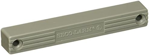

They actually make wide gap contact sensors like these:

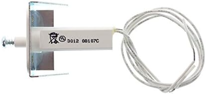

The problem you are going to have with any contact sensor is that to detect when the door is just barely open is very difficult. You want to make sure that the sensor is as close to the opening side of the door as possible to give it the greatest distance of travel when it is open. What might actually be better is a contact sensor that works off of a plunger, like this one:
Now, how you would rig that up to a fridge? I have no idea. Just throwin it out there as an alternative you might be able to use.
