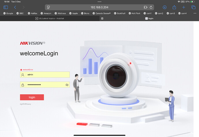

I have three cameras with similar configurations. I have a 4th camera with motion sensor tracking with a different configuration, no mention of alarm server so I tried to use HTTP server. Unfortunately I cannot even log into that camera on its IP of 192.168.0.204 - getting “network error” even though it is still connecting fine with the NVR which it is live and recording on. See:
