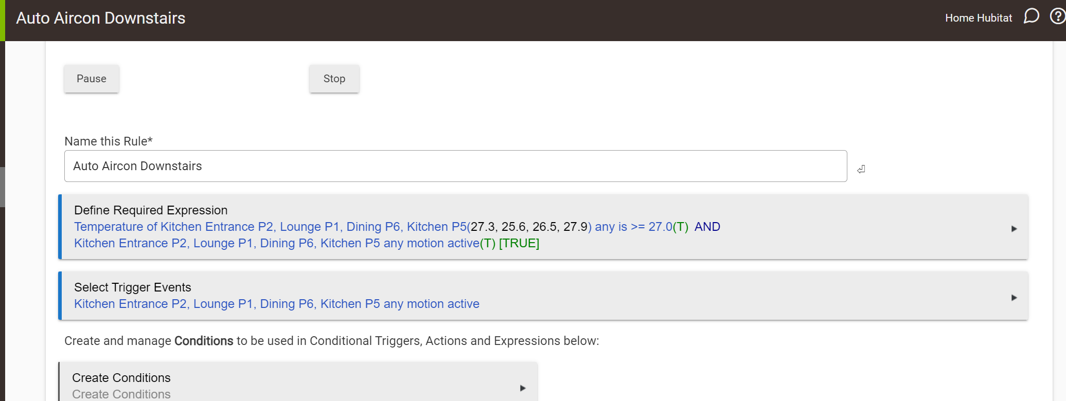

I can not see anywhere to add >15 min inactive in expression or conditions.
i would like to auto turn on aircon down stairs (which turns off upstairs room aircon) if:
There is no activity on any device upstairs (device 3,4,and 5 for >15mins)
and
Temp on downstairs sensors is =>27deg
and
motion is detected on any of the downstairs motion sensors (device 1,2 or 3)
and
house mode is not in away mode

I expect you will need a combination of triggers and conditions for both the motion sensor groups. Personally I would think you could just turn on the downstairs a/c the temperature is high and motion is detected..
The temperature you can add as a required expression.

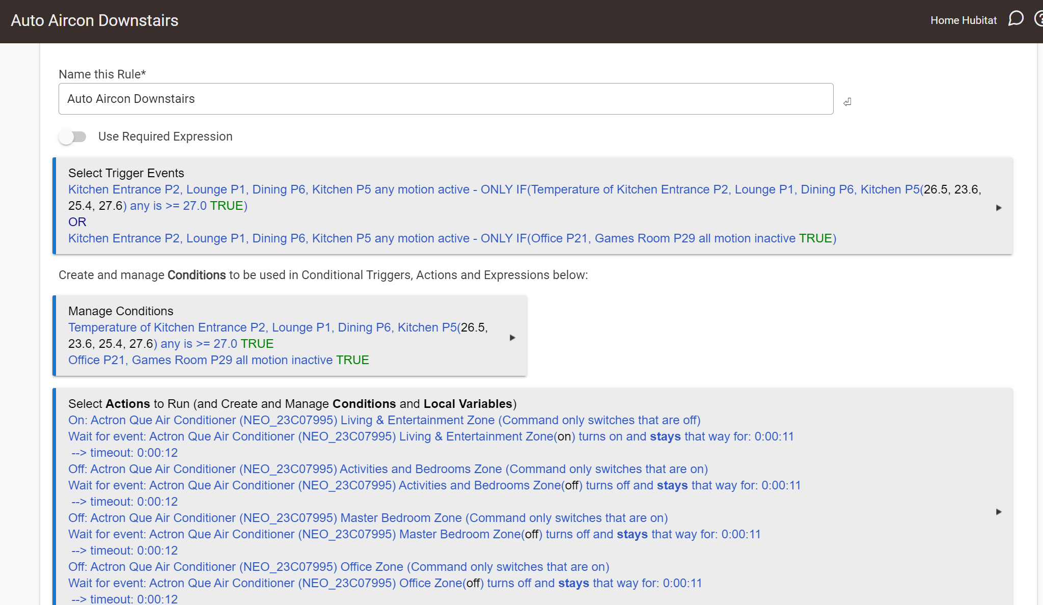

For the inactive motion I think you'll need a second rule to track them and set a boolean hub variable (or set the first rule's private boolean directly).
First Rule
Required Expression
Temperature of Dev1, Dev2, Dev3 all >= 27.0
MotionInactive is True
Second Rule
Trigger Events
Dev4, Dev5, Dev6 all motion inactive and stay that way for 0:15:00
Actions to Run
Set MotionInactive True
Wait for Event: Dev4, Dev5, Dev6 any motion active
Set MotionInactive False

Triggers in Hubitat are based off events. If there is no event, there is no trigger. Required Expressions, conditional triggers, and conditional if/then actions all provide the flexibility necessary for your rules. It's just figuring out how to define it within the Rule system engine.
Based on the above, your request is tricky. Inactive greater than 15 minutes is generally an expression. You need an event of inactive to start the counter. Without the event, Hubitat would view this as an expression that needs to be evaluated. This could be done in the actions of your rule, but not in the triggers or required expression.
However, there is away around it using Hub variables like @pseudonym suggested. The other way could be creating an motion aggregation zone with an Activity Timeout of 15 minutes (Zone Motion Controller | Hubitat Documentation). This would create a virtual motion device that only goes inactive after the Activity Timeout. Your m-Zone inactive could be used as a required expression with the temperature can help with the rule.
Required Expressions:
Temperature equal to or greater than 27
m-Zone inactive
Mode is not Away

If you wanted a trigger on the individual device reaching a certain temperature, just create a second rule and define it how you want. It is perfectly fine to have multiple rules working together rather than one large complex rule.
