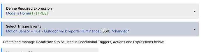

Hi everyone:
New post, since I could neither respond in this thread (nor find the answer anywhere else): Conditional Triggers in Rule 5.1
Question: How do I set up multiple conditions for one trigger? I.e. "Fire the rule at 12:00, ONLY-IF something AND something is TRUE"
Reason: In some of my intricate rules, every possible place where a condition can be introduced (1. required expression, 2. conditional trigger, 3. conditional action) has its purpose, therefore sometimes I am limited to, for example, a conditional trigger. Alas, sometimes I need more than one condition for a single trigger, which brings me to this post

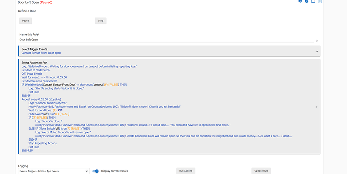

I use them to interrupt rules. Here is an example of a virtual switch to interrupt a rule...
Note: I'm not answering for anyone else. Just showing how I myself use them :slight_smile:

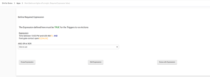

I think you are wrong about this. Private Boolean has very predictable timing. Your examples all entailed using PB in a Required Expression, and your comments about timing pertain to the Required Expression changing state, not to Private Boolean changing state.
However, testing Private Boolean as the first action will work 100% reliably, because Private Boolean is set instantly within a rule (faster than turning on a switch).
For Required Expression timing it is important to note that Required Expression is evaluated separately from the rule (it has its own Event Subscriptions). So, there will be multiple instances of the rule, and your experiences had to do with the relative timing of those instances, which cannot be guaranteed by the hub.

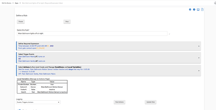

If first two actions of rule are
IF(PrivateBoolean false) Exit Rule
SetPrivateBoolean false
And last action is Set Private Boolean true. There won't be any timing issues at all, as there is only a single instance. If a second trigger event happens before setting PB false, then obviously a second instance will run from that (and the best laid plans fail). But this would be equally true for using a virtual switch.
