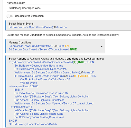

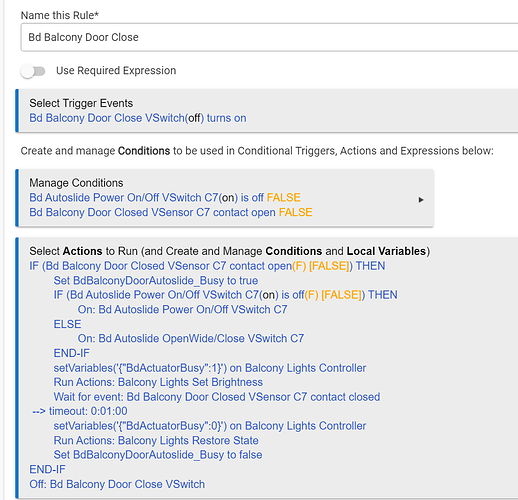

Just in case here is an example how VT is used as a Trigger and Status for rules synchronization:
Main rule for opening balcony door (VT is a trigger) :
Main rule for closing balcony door (VT is a trigger) :

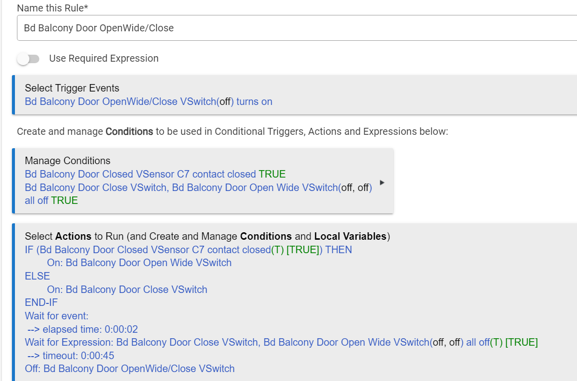

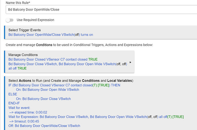

And a complementary rule for opening/closing balcony door
(Set the appropriate VT for triggering one of the main rules and uses both VTs a Status for Done condition):
All Triger VTs are used elsewhere else (few remotes and dashboards).
