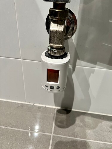

Soon, however, I'll need to revisit it, so this is helpful. We have actually changed all the TRVs to TP Link Kasa TRVs. These have been popular, because other people can operate them easily, either manually in an intuitive way by simply turning the knob, or via the Kasa app, which is also easy to use.
