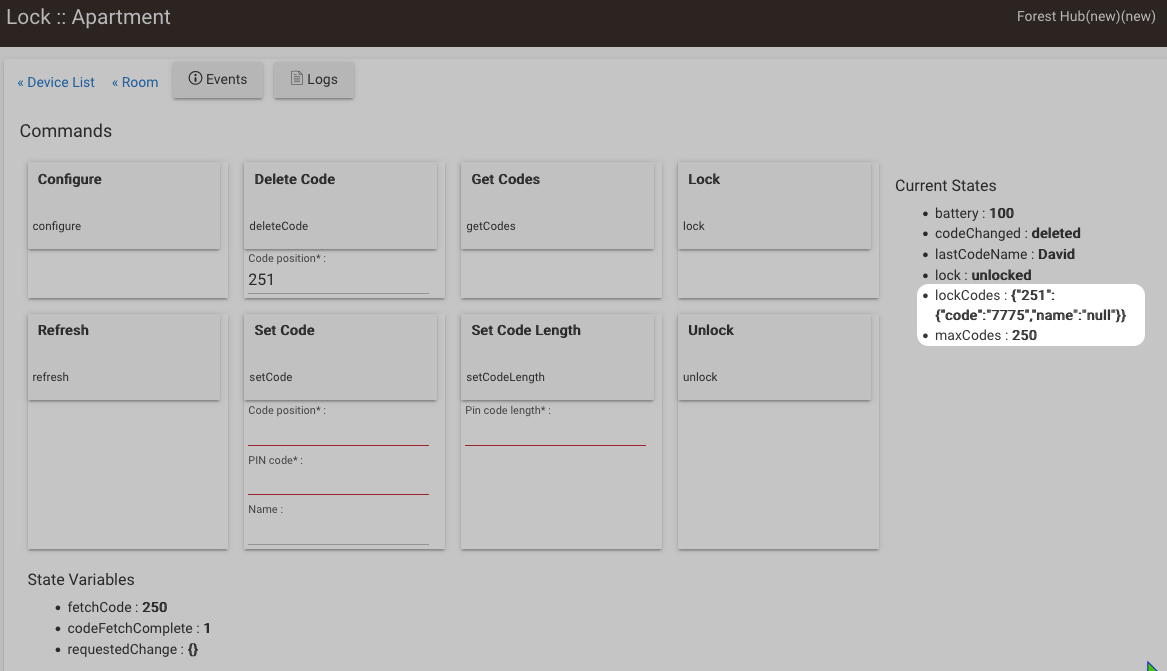

Cleared the "Front Door" and "Apartment", kind of.

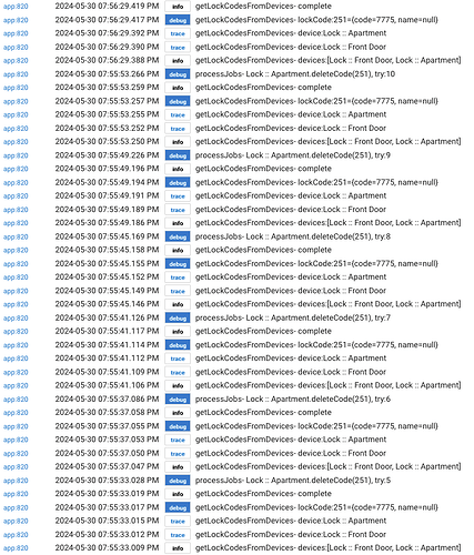

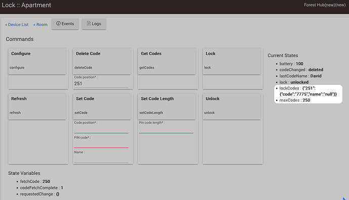

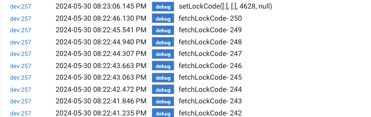

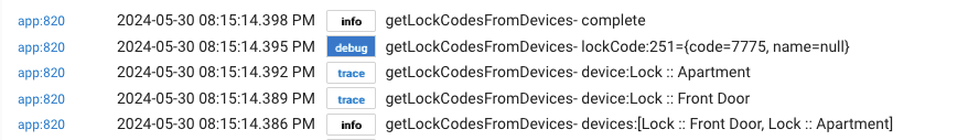

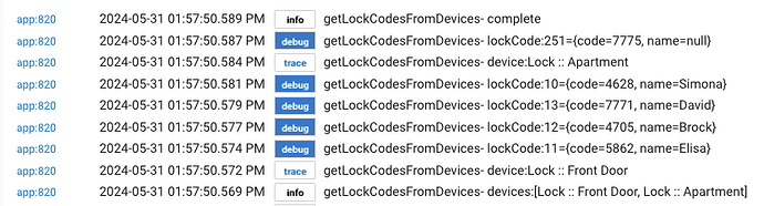

What is that all about? Position 251 when "maxCodes: 250"? Does that make sense? And, 251 can't be deleted in the device screen. LCM agrees and generates a lot of "debug" entries and a bunch of retries when I try to use it to delete 251.
A few of the retries showing in the log. There are several more. Don't know why but the .png of the log will not load into this message. Will create a separate message with the log.

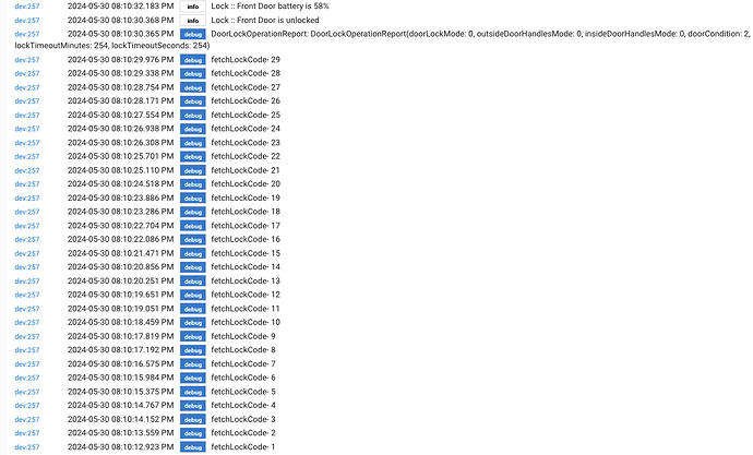

The log entries

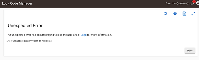

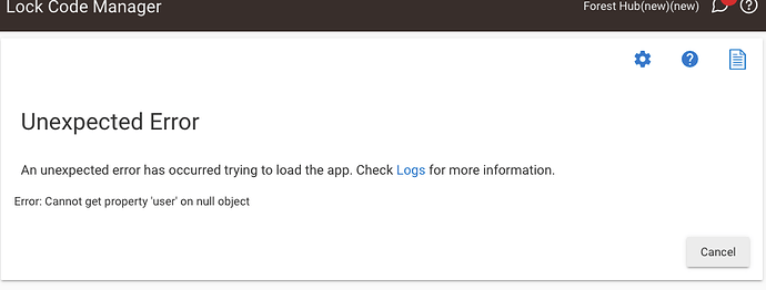

Tried to use LCM to add a code. Got an error.
That generated a lot of log entries. About 30 retries.

Great question @danabw . It certainly does, so I tried to "disable" the 7775 code in LCM and that generated a cascade of "debug" messages.
I'll spare you the other ~240 entries in that sequence! :grin:

Hey @rlithgow1 , yeah, I deleted all entries using the Device page for both of the 2 locks. Tried to delete position 251 from Apartment with no joy. Rather interesting that there was no clue that the operation executed, succeeded, failed, or decided to take a vacation. Nothing displayed. Nothing in the log. The net net was I couldn't delete the 251 code. Check out the 3 screen captures from a couple posts ago. (We now measure time in "posts"? :wink:)

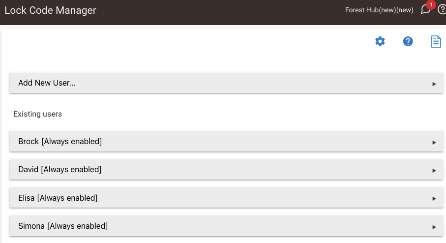

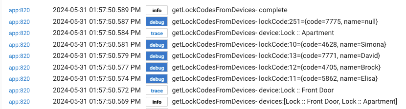

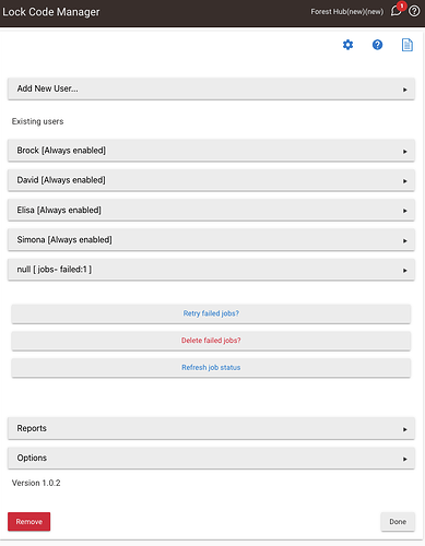

Just for reference ..... here is today's LCM view of the world. All names are on the Front Door lock.

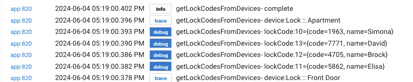

And the corresponding log from opening LCM.
Everything looks desirable except that pesky 251 slot.

Using LCM, deleted failed jobs. I see 10 attemts by LCM in the log.
Drat. In LCM "null" remains. Persistent bugger.
Refreshed the browser screen for the device. It also shows "null" remaining. Double drat.
2024-06-04_11-10-42
Also tried deleting the code from the device screen. No joy.

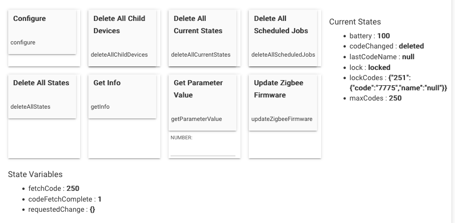

The "Type" dropdown on the device page.
Make note of the current type (aka Driver). Switch it to "Device" and save.
Then you will see the two command buttons I am taking about up top.
Once done switch back to the original driver and save.
The follow the rest of the steps I listed above.

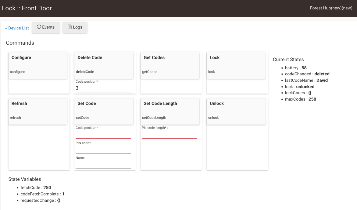

Clearing the lock seemed to work properly. I'll add a couple captures to make this thread useful for future readers.
Changed the driver to "Device" using the "Type" dropdown. These buttons were displayed. I used "Delete All Current States", "Delete All Scheduled Jobs", and "Delete All States".
Changed the driver back to "Generic Z-Wave Lock"
The log shows Apartment codes have been cleared. The Device page also showed the values cleared.

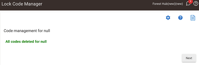

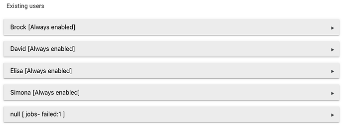

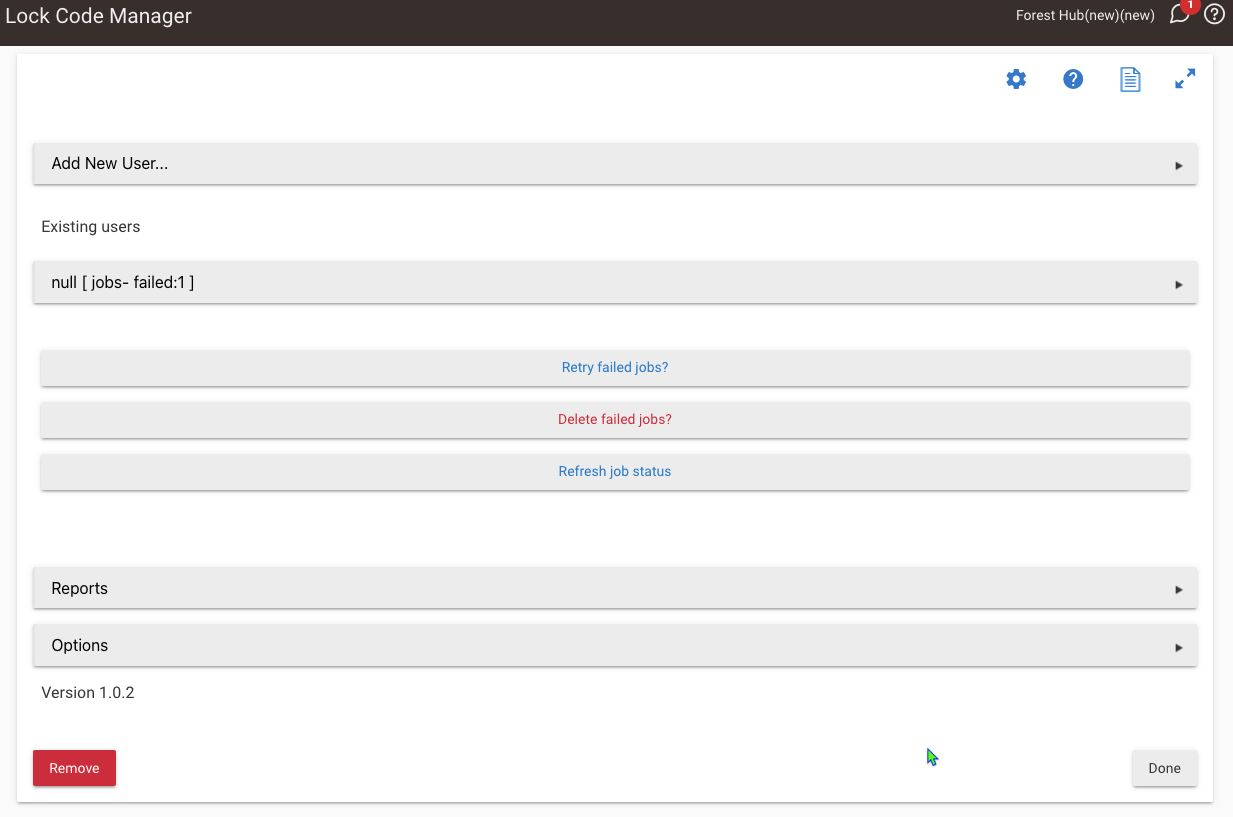

The LCM showed the "null" user and the failed attempt. Used LCM to clear that user. Seemed to work. Now looks like this

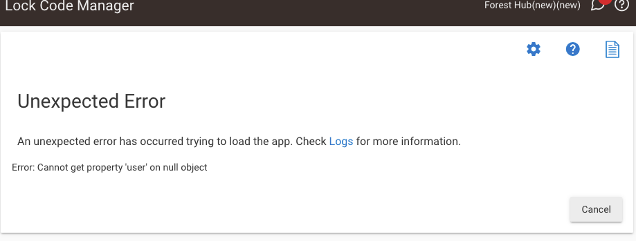

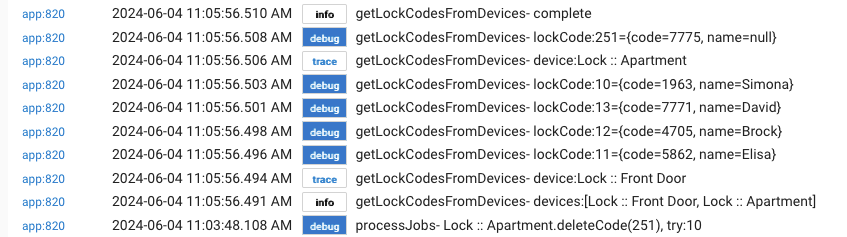

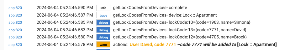

Tried using LCM to add the Apartment lock to the user David. An error appeared.

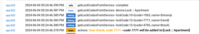

The log showed this.
Opening LCM to stimulate a log entry shows that

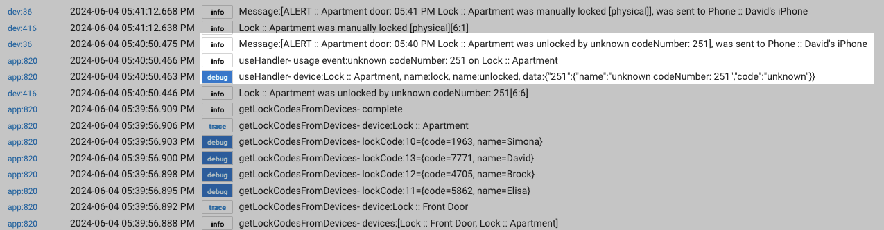

Entered the 7775 code on Apartment and the lock opened. It is shown in the log. Our old friend is back. Gobs o fun!
