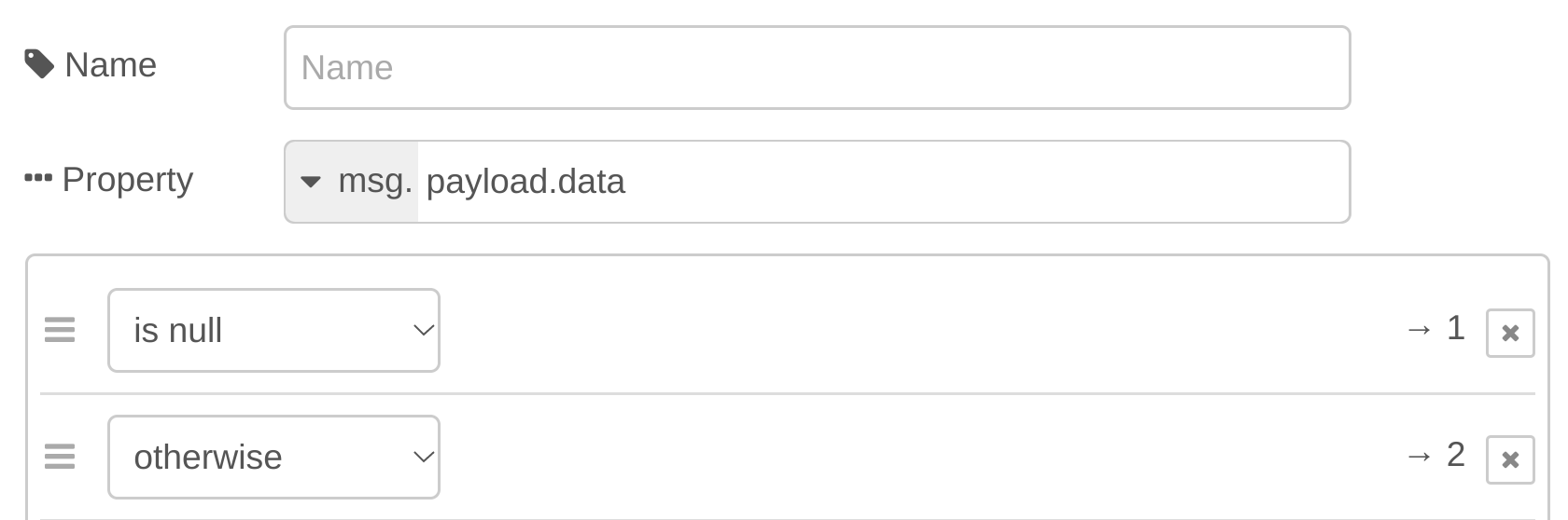

Probably a switch node that checks for msg.payloada.data=null + an "otherwise branch".
Each path going to its own function node, one for manual events one for codes.
Switch:

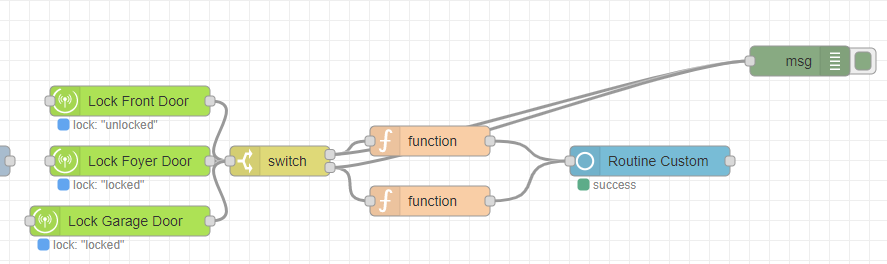

Ok so, I've got it working. There's one thing that I don't like and maybe you can tell me how to extract that information from the output but here's the flow as it stands. It's an all in one solution and works with all 3 locks connected to the flow.

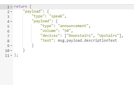

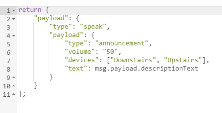

function for null
Function for Code

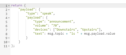

But I don't like the output for code. It announces the physical state:
Is there any way to define the data but only the name?

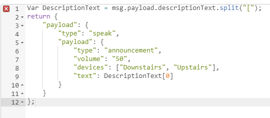

You could cheat once again....
Var DescriptionText = msg.payload.descriptionText.split("[");
and just change your "text": to...
"text": DescriptionText[0]
can i add that into the existing function that I've created?
Yes, just place it before your return line (Line 1)
getting an error
expected an assignment or function call and instead saw an expression
missing "," before statement
Change the Var to var.....
