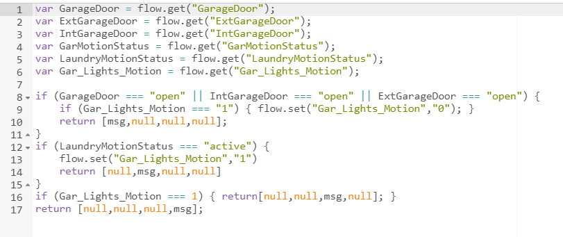

Posting a random example of something I use for the lights in my garage....

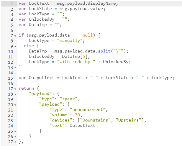

If you were feeling adventurous, would you mind trying something with that function?
Add a line before line 1 that reads:
msg.warn(msg.payload.data[0].name);
Monitor your debug log and try your lock. I'm curious if that would give you your name, "Home". (Trying to learn something new here.) I have a suspicion that it will return null.
Just remove the line afterwards.
I expect not, as the data item value isn't properly formed json. It is only json-esque.
But doesn't hurt to try...
Errr....need more coffee.
It should be node.warn, not msg.warn
it made the announcement like normal. Did it on two doors
Anything in the debug log? I'm guessing it returned "undefined".
yes undefined. what were we warning of?
That was an attempt to pull the "name" from the malformed JSON data. Didn't work, not too surprising though.
{"1":{"name":"Home","code":"2222"}}
Thank you. Also, when writing your own functions, that node.warn is very helpful to help troubleshoot. You can comment out the line so it doesn't run by preceding it with //
Ok, toyed with this a bit...came up with one way to get your "who" from the data.
var dataTmp = msg.payload.data.split(""");
var WhoDidIt = dataTmp[5];
So, the kludge I typed above would look like....
Totally unnecessary when compared to what you have currently. Just gives a bit more control to the output text itself. (Don't really need the variables for displayName or value either.)
