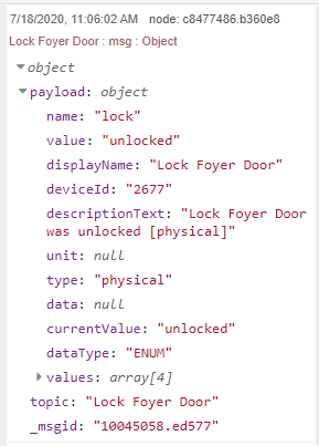

here's the debug of the lock. A LOT more information there.
OK. Now, if you're lucky the manual events will all be type physical - but who knows? If they are though, that could be a very valuable bit of data to use in deciding how to construct the alexa payload.

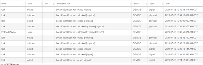

Well, you can also look in your device events on the hub. Whatever is reported in the type there is what will show up in the node-red event.

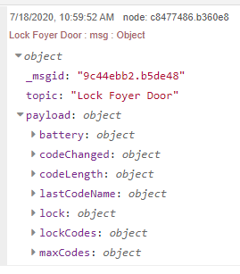

Ok so ... If i use the node object lastcodename then the current value is the name of the last code entered. but doesn't trigger on a physical lock or unlock. Could I set up the flow to use all and pull the info i need when it locks or unlocks?
maybe not ... it reports everything, so it woudn't report the change I dont' think
Multiple flows is inherently harder, especially if the # of msgs is different in different scenarios (like when there is no lastcodename event).
Why do you need the lastcodename event at all if the code used is in the msg.payload.data field of the lock/unlock event?
It doesn't log it unless the node is set to last code name. Let me double check that.

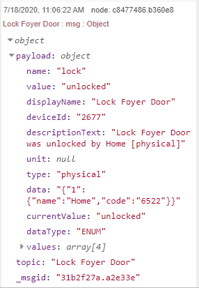

The event you posted earlier had the code on the unlocked event in msg.payload.data, for instance.

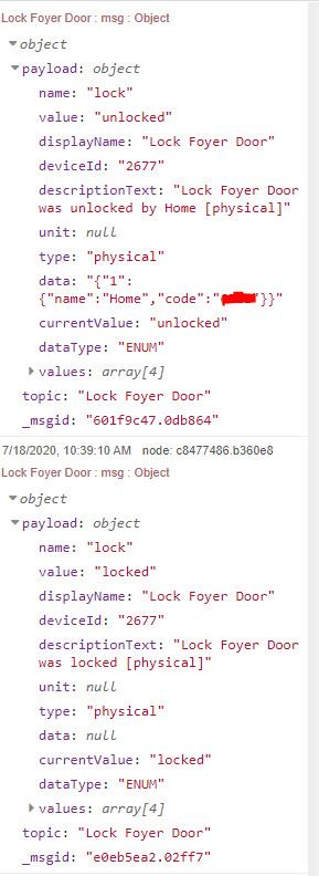

Here are both. unlocked physical and unlocked with a code. I only have the debug on the lock status node. locked or unlocked. Here is the output for both physical and code.
Exactly. Notice "data" is null when unlocked without code, and has a value when unlocked with a code.
So a switch node checking for null on msg.payload.data will separate manual vs code events.
