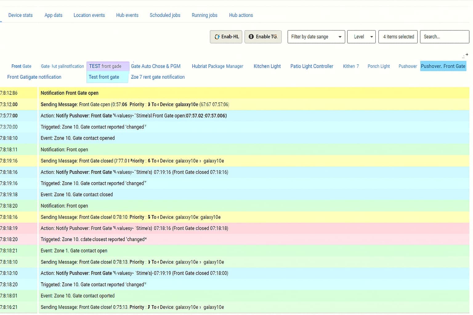

Im now trying to build a chrome extension that can do this. I got it to work but only for past logs, not live logs. Any ideas on how this might be possible?

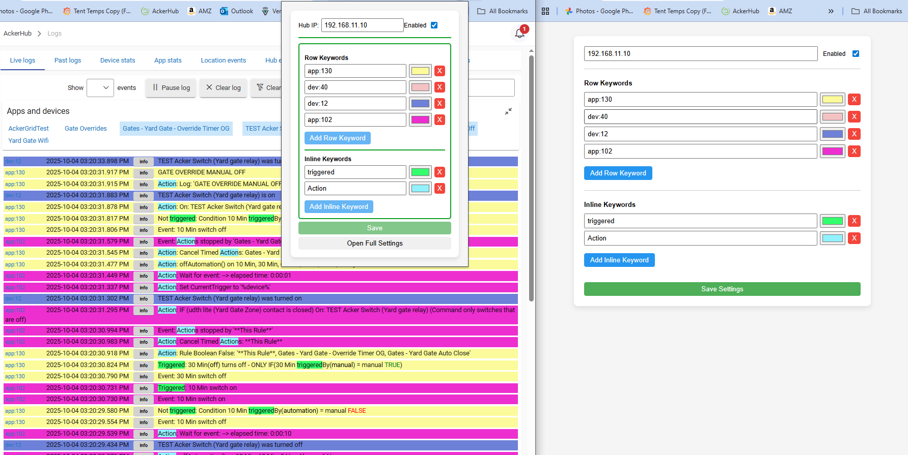

For anyone that is interested I have created a very basic Google Chrome extension that will color code live and past logs.
To Install:
  1. Download zip file and unzip
  2. go to chrome://extensions/
  3. Click Load Unpacked and select the folder
Setup:

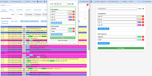

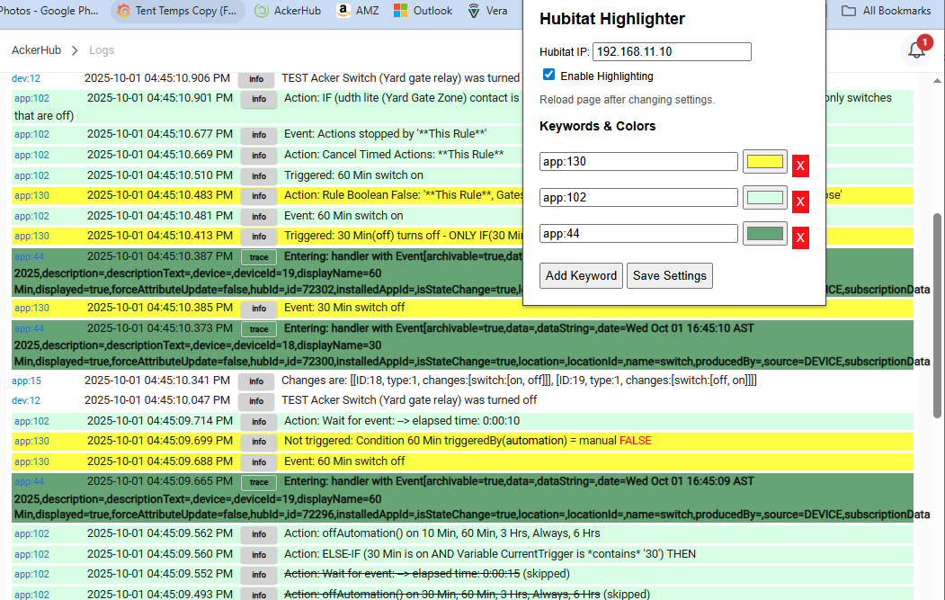

  1. Click the Hubitat Live log Highlighter from your list of extensions and a pop up will open.
  2. Input your Hubitat IP address
  3. Click Add Keyword and input the device or app id as you see it in the log (eg. app:130 / dev:40)
  4. RELOAD THE PAGE (F5)
To disable color coding simple uncheck the Enable Highlighting check box.
Suggestion: Use the standard Log Filter by app/device to filter only the devices and app you are working with.
NOTE: In this version ONLY the app/device ids will work for keywords. You cannot use a word that is in the middle of a row.
Edit: Link removed. See new version in post below.

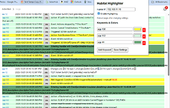

V4.5 now supports inline string searching.
-Separated Row and Inline keyword inputs
-Additional options page can be opened in another tab. Convenient if you want to keep the keywords open in another window.
EDIT: Updated to V7
https://drive.google.com/file/d/1OOw6fF0Ysx8ixK7pP9jbtwjMnmIsyD42/view?usp=sharing
