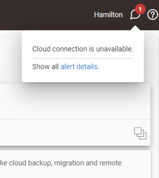

All of the sudden, I can't reach our hub outside of our house. I log in and it shows I have one active hub on my account, but when I try to connect, it says the page can't be loaded. The hub (from inside our network) keeps throwing error notifications that the cloud connection is unavailable.

Reboot the hub. It should reconnect. Some cloud re connection issues are being addressed in beta.
Dang...every time I think I've included every step, I miss one. I've rebooted several times over the last few weeks. I'll try it again. Hopefully an update coming soon will help. :slight_smile:
That isn't the latest release *.196 is:
Given your hub cannot reach the cloud it likely won't prompt you to download.
Reboot then update, latest release fixes some more cloud issues.
Yeah. That's exactly what happened. When I checked for updates under settings, it said it was the most current. After reboot, it's showing the update. Doing that now.

I had this issue last week. I had to reset the network using the little button on the bottom of the hub. hold it down for 10 seconds. Havent had the issue since..
I'm on 2.3.9.199 and I'm having this usse. I rebooted, nothing. I rebooted again, nothing. I shutdown and disconnected power for ~10 minutes, nothing.
Can you press the network reset button on the bottom of the hub for 7 seconds using a toothpic or a paperclip? It will be the only round hole out of all the square holes.
That did it, thanks
Do an immediate update. Then set a DHCP reservation on your router for the hub.
If the network reset fixed it them I am guessing you had incorrect DNS settings, and the reset cleared that out back to defaults.
I did the update. I already had the reservation in place. Thanks again
