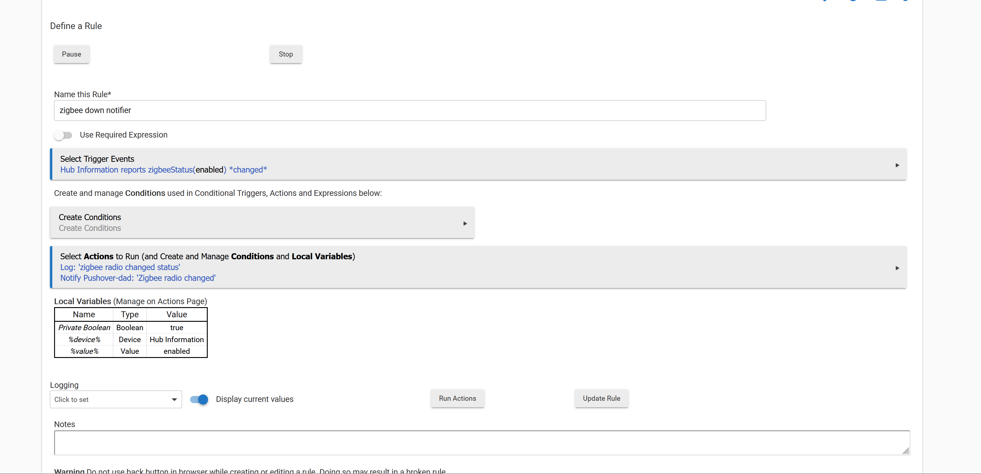

zwaveCrashed is a location event. You don't need the Hub Info app.
I have a rule that, in the event of a z-wave crash, shuts down the hub and kicks off a rule in my spare C-7 hub to power cycle the main hub via a ZEN16 powering the main hub.
Plus, the main hub sends out Pushover and Ecolink chime siren notifications when z-wave crashes. That alone could be helpful.
