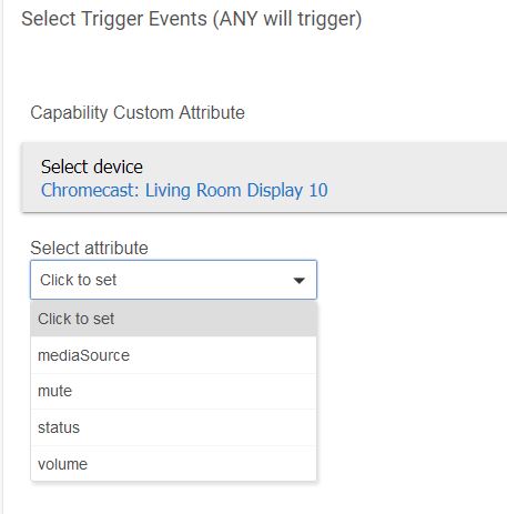

Perhaps I'm missing something with the Chromecast Integration. Is is possible to get the status of a Chromecast when it is playing to get status to control lighting?
I believe so. My dashboard shows current status of my chromecast devices (I use Lenovo displays) and you can read the attributes from RM with the custom attribute option.

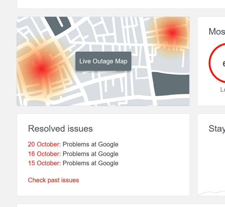

I had issues with my groups disappearing. (Happened to look, and downdetector said google was having issues today and coincidentally a few days ago when they disappeared last time). Did not appear to affect the physical devices. Just the created groups of multiple devices.

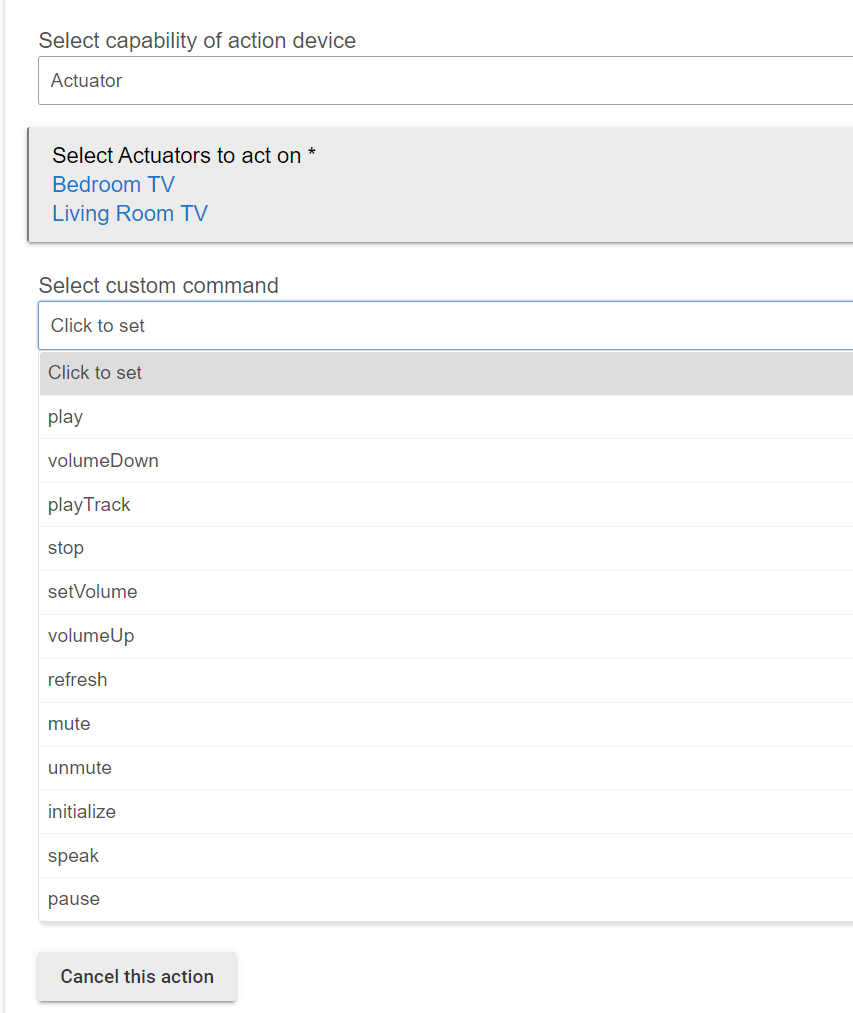

Has anyone worked out how to send the off command to chromecast ? My tv can turn off with the off command ths connected chromecast via Google home. So I'm assuming I can do it through habitat as well?
Chromecast only finds my Nvidia Shield (connected to the 4K set) and none of my Samsung Smart TVs so I do not know how to handle TVs with it. Same for Logitech which only finds 1 of 3. The plasma HDTV still makes 4K look weak.
I have 2 4K and one plasma HDTV on my network but only the NVidia shield was found and it has 12 actuators. I would like to be able to access the TV it is connected to but can not yet. Anyhow, Initialize, Mute, Pause, Play, PlayTrack (with a parameter), Refresh, SetVolume (with a parameter), Speak (a text to audio function with a parameter for text input), Stop, Unmute, Volume Down and Volume Up are available if someone wants to start figuring out how to use one with Hubitat Elevation. Mine says the media source is "Plex".
Usually you use "Run Custom Action", "Run Custom Action", "Actuator" to get to any of those functions. I would say 95% of my rules are "Custom". You can then find the device and then the off command. I have done this a lot. I do not even know what most of the other useless options are.
You can only stop the stream. You can't turn a TV off using the Chromecast device. You likely can do that using a driver for your TV, if one exists.

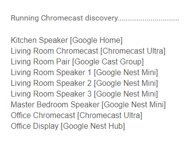

I recently ran across this Chromecast and thought I would try it. I have a google clock. The driver found the clock. I tested it and was able to make it talk. Great. Created a test rule that was to run last night. It didn't work. So when I checked this morning my clock had changed IP address. Does the driver detect this? Or how do I tell the driver to find the clock again? I did go into my router and set a static IP, but still can't get Chromecast to refind.
Edit: Figured out how to rerun discovery, but I assume this won't happen automatically?
Now I'm really getting confused. Told my router to give the clock a permanent IP address. Reboot clock. Check IP of clock, not what I told it. Check router. Apparently clock has a different mac address. Redid. Everytime the clock reboots it comes up with a different mac address.
Does that make any sense? I can't quite figure out what is going on.
