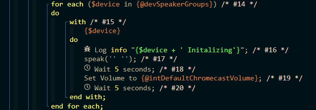

I have had many tries at this over the years and the solution for me was to Speak a blank char, wait 5 seconds and then the set volume.
Speak wakes up the speaker to receive a setvolume command.

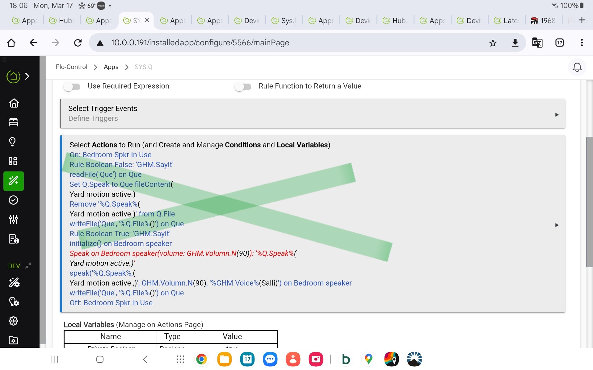

Here is a part of my system start piston that finally works and the volumes to a known value on a boot.
I have been doing the same thing for years too
I had been using this, then switched, and it worked.
Now switching back is the option.
