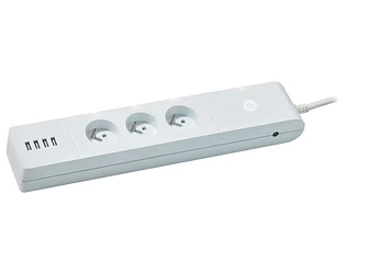

I also have these... (see picture) from lidl. 3 outlets to control and 4 usb (no control of them).
I have also 2 ot those Lidl... I like them A LOT.

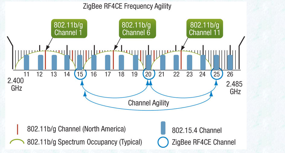

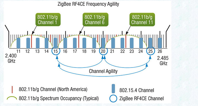

My Hampton Bay Fan Controllers worked fine until I changed my WiFi topology to a new Ubiquiti Unifi setup about 2 months ago. Then my Hampton controller in the bedroom would just lose connection. I reset it and repaired a few times and thought that the fan controller was on the fritz. Then it occurred to me that the timing of the issue began after changing around my WiFi. As you probably already know, WiFi (802.11 N,B, & G) and Zigbee all live in the 2.4Ghz ISM (UNI) band, as does microwave ovens, baby monitors, some cordless phones, bluetooth etc. The problem with that portion of the spectrum is that it has been overcrowded for some time. Using that spectrum has to be carefully managed. Zigbee is no exception. Attached is a diagram showing the ISM band WiFi and Zigbee channel overlaps. After relocating my Wifi access point further away from the Hampton Bay Controller and changing the Zigbee channel in Hubitat (may take a little while for all the Zigbee devices to re-home to new channel), my problems went away. Adding repeaters to Zigbee is one way to "fix" the problem if you have some devices on the fringe of the reach for the mesh but more likely radio interference is the issue and adjusting your mesh to "play well" together with other technologies in the same radio spectrum can give you a lot of relief and cost nothing. I currently like Zigbee channel 26 because it does not overlap with WiFi channels. I have found an older zigbee device that would not pair using that channel but it is rare.
One other consideration is the radio spectrum usage that you cannot "easily" see unless you have a spectrum analyzer. Bluetooth, some older cordless phones, baby monitors, microwave ovens, etc live in that spectrum as well. WiFi and Zigbee use a modulation technique called Direct Sequence Spread Spectrum (DSSS) that spreads the information across a chunk of the spectrum in a sequential "block". WiFi into 3 non-overlapping channels (1,6,11) and Zigbee into 26 non-overlapping smaller channels. DSSS stays somewhat contained in its block. Bluetooth, baby monitors, old cordless phones use a modulation technique called Frequency hopping spread spectrum (FHSS). They divide the spectrum into small chunks and it "hops" between them ALL using the entire spectrum at some point, bouncing around all over the place. Bluetooth uses 79 1Mhz channels and pops all over the place and WILL land smack in the middle of your WiFi and Zigbee DSSS channels randomly at some point. Luckily WiFi and Zigbee have error protection and most of the time recover, but not always. Also consider that "leaky microwave ovens" can cause havoc also as they transmit a lot of power and live in the 2.4Ghz spectrum also. The transmissions by the oven are supposed to be contained inside the oven in kind of a Farraday cage scenario. If you have that, then you have a health hazard also but it DOES happen (warped doors, bad seals, etc)
So take a look at your WiFi channels (and your neighbors). Remember that most access points are set to move channels to the least busy (but they don't necessarily look at other non-WiFi spectrum users to make that decision) so they can relocate to other channels unless you turn that "feature" off. Also your neighbors need to be considered as well. Then after assessing the spectrum utilization make a choice of Zigbee channel. Also the close proximity of your Zigbee devices and your WiFi access points matters also. With a little radio spectrum management, you can have a healthy, happy Zigbee (and WiFi) network.

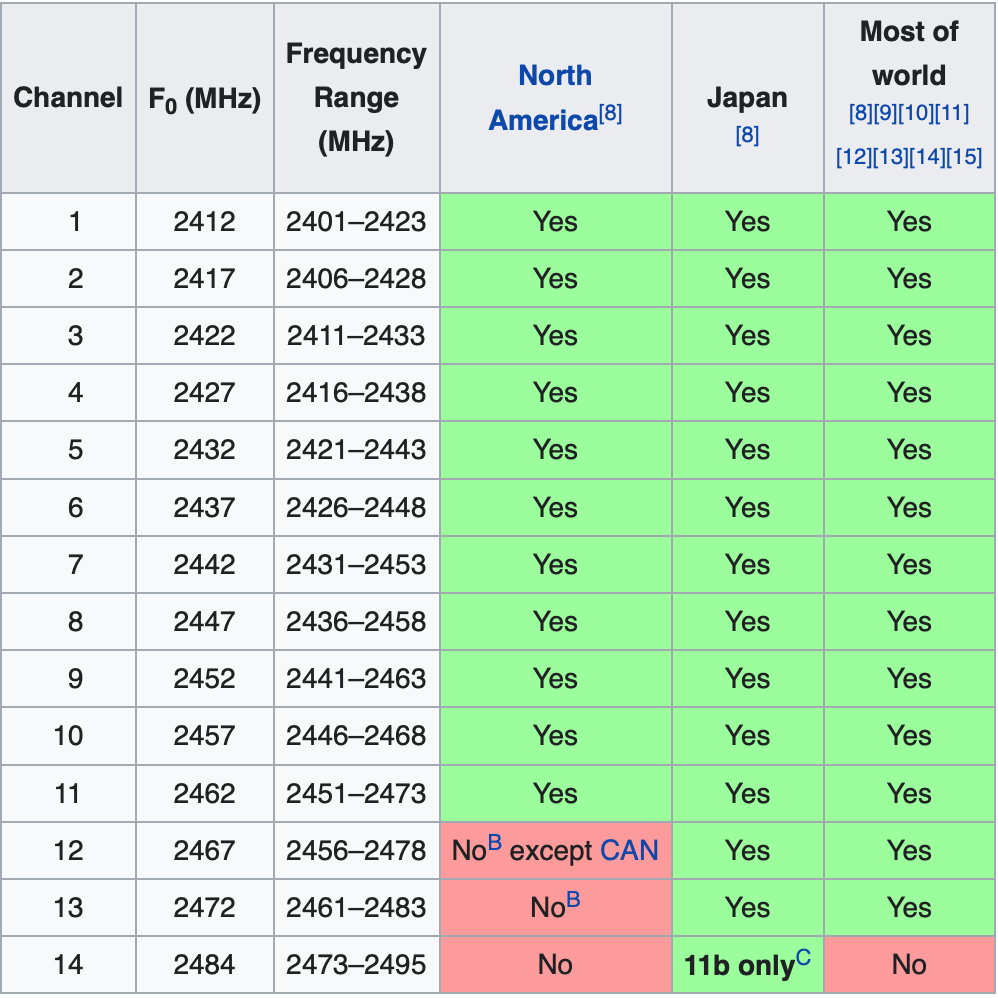

I must also note that this is the scenario in the U.S.A. Other countries have different regulations and requirements. As you can see in the chart below, some of the higher WiFi channels in the 2.4Ghz band are different in other areas around the world and will affect the overlap of Zigbee Channels 25&26.
