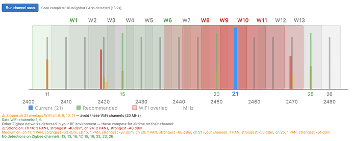

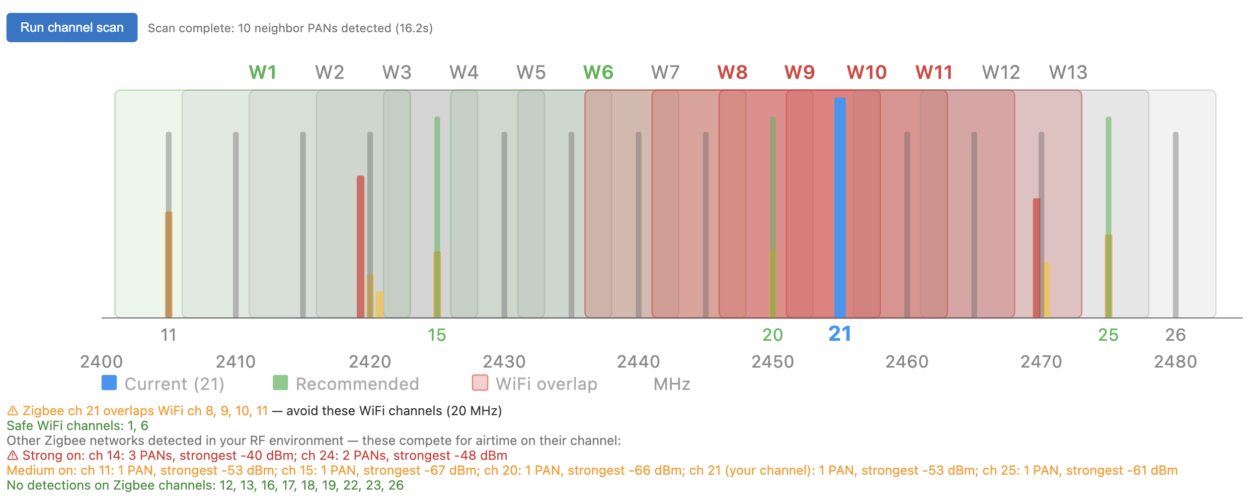

Hub Diagnostics integrates the Zigbee channel scan with a diagram of both Zigbee and wifi channels, if that can be helpful (Network tab).
