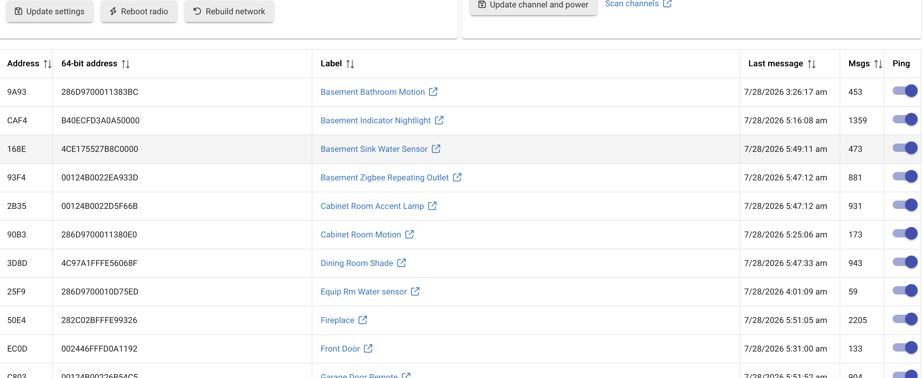

Settings → Zigbee Details will give you a long grid like this:
Then I copied it into an excel spreadsheet. Eliminated most columns and added a “Verified” column. After that all I had to do is see if the device is reporting or not. If it is, it made the switch to channel 25.
