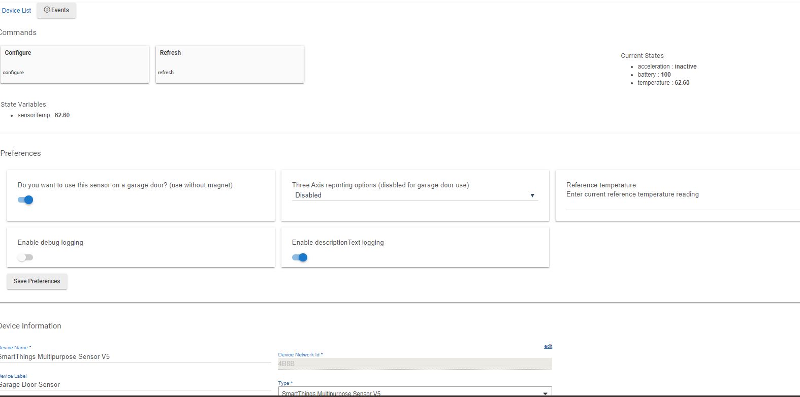

Hi All, recent wink convert and so far everything has gone flawlessly. I have myq lite installed with a liftmaster and a ST multipurpose v5 sensor. I think I have read all 400+ messages here and don't see my problem. I have the sensor set to "Do you want to use this sensor on a garage door? " My door: is always listed as "opening" or "closing" until I manually set it to open or close. At that point I can control it from the dashboard. the door sensor: always reads as " doorSensor : Garage Door Sensor is null" so until I manually set the door to open or closed I can't do anything from my dashboard tile. So it doesn't appear to be reading the sensor. I have removed both the sensor and garage door device half a dozen times and then rerun the myq Lite app.
The sensor does show "active" or "inactive" when there is or isn't motion.
I can also open or close the door from the Garage Door device.
What am I missing?
Chris

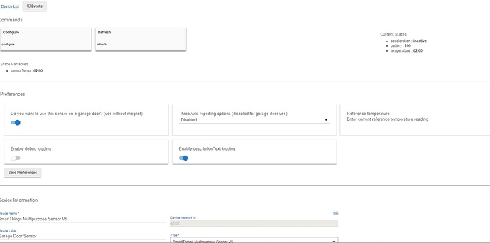

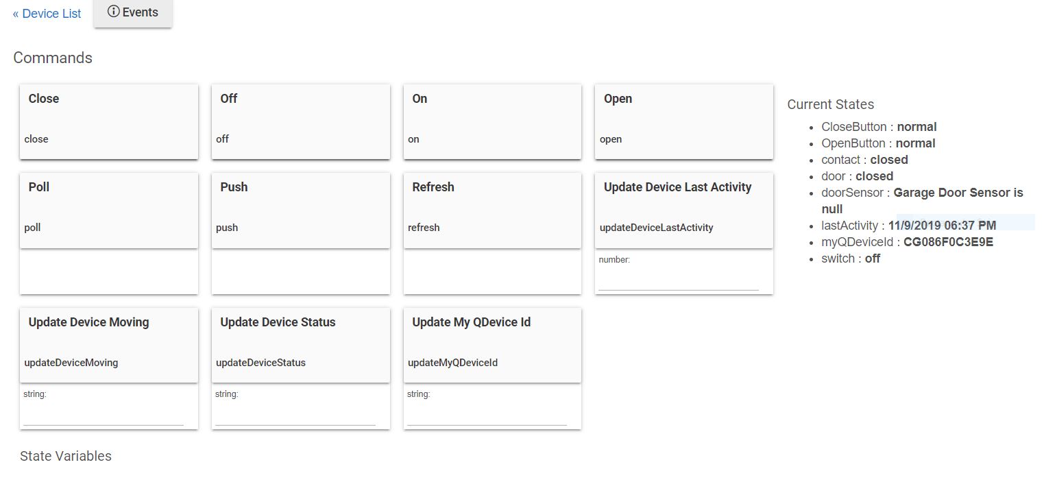

I am setting it manually by typing open or close in the Update Device Status field of the virtual Garage Door device.
My ST sensor looks like yours other than I do not have a contact: field.
The virtual Garage Door is also like yours except the doorSensor: always says "Garage Door Sensor" is null. Obviously the Garage Door Sensor is my ST tilt sensor.
Ok, well all is working now. I had read another thread where because two device names were close to the same they were having issues. I tried changing my Garage Door Sensor name to Garage tilt Sensor. When I hit save, the "contact: closed" line showed up, but the name didn't change, it stayed as "Garage Door Sensor". I then hit the garage door tile in my dashboard and the doorSensor: line changed to "Garage Door Sensor is open".
Anyway It is all working now.

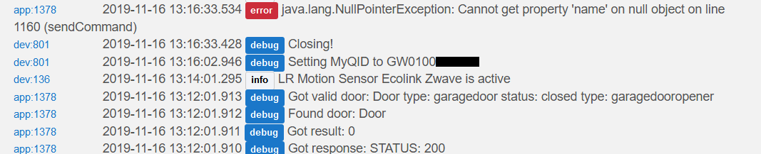

error using the latest nosensor device.
Worked prior to the MYQ update. Installed latest Myq app and nosensor device, successfully set device id into driver. Garage door functions normally with Android MyQ phone app.
When clicking on Device's Close or Open the following error is thrown. (ignore dev 136 it's extraneous)
Thanks to all who worked through this. This is awesome. I can officially confirm the no sensor version works now. (Yeah, I'm too cheap to buy the sensor for all 3 doors. Still working through other higher priority smart things.)
