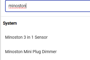

I'd just added two of these N4012 "New One" devices, and HE didn't find a match, only came back as device "Device", and no options to control the device.
futzed around with various other Device manifests and settling on device setting to " Minstion Mini Plugin Dimmer".
So, given the context of this thread, HE has a breaking change for this device?
