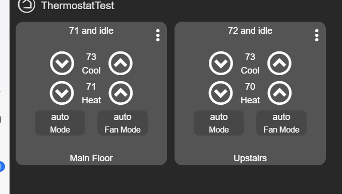

Can't adjust set point not on thermostat tile
That is odd.... I have had this for a few years and it was apparently just "generic component"
Appears to have done the trick
NOTE I had to go to HA and click to "heat" and back to "heat_cool" to get it to show auto for the first time. Might have been able to do the same in HE

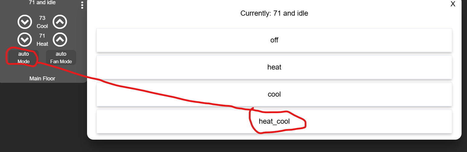

Ran side by side in separate windows.
Using the dashboard to select the following modes resulted in instant changes on the HA side:
HE HA
Heat Heat
Cool Cool
Auto (heat_cool
in dropdown) Heat_Cool
Also confirmed existing rules unaffected
