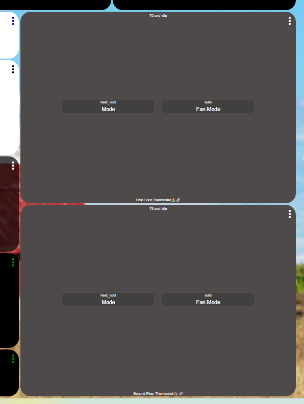

I know I used to be able to enter set points on a Thermostat tile. These are Ecobees coming from HADB. The Thermostats have all of the appropriate states.
I'm stumped.

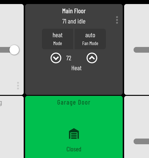

Here is one of the dashboards. I copied from desktop but it's sized to fit on a tables to that is reason for weird ratios.
I'd suggest visiting the 3-dot menu for that tile to make sure its device is still selected properly then click Close. Looks like the correct template is in place, though.
They are selected. The current temperature changes and tile background changes color based on state. I created a brand new dashboard and it is same issue.

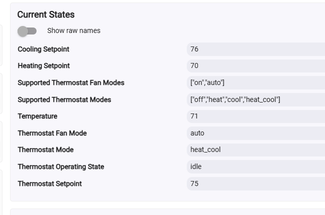

What driver are the Ecobees using in Hubitat? Also, check if your dashboard is using any custom CSS.
I can't adjust the set point either on my Ecobees. The only thing the arrows do on the tile is change the 'hold' temperature.

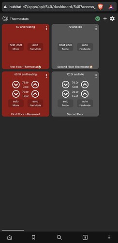

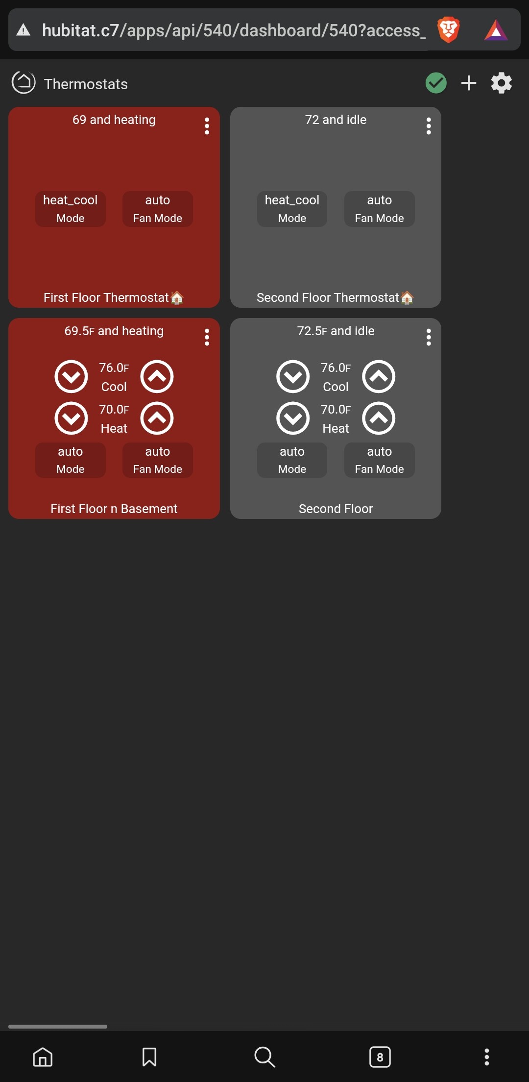

It seems to be HADB related because i added thermostats using Hubitats native Ecobee integration and the setpoints are there on tile. The top two are from HADB and bottom 2 are from Hubitats integration.
Now I see, lol. That's worse.
In that screenshot, the current thermostatMode is heat_cool. The dashboard template follows the Thermostat capability enums only, and that is not a valid mode for the template to display setpoint controls on the tile.
  • thermostatMode - ENUM ["auto", "off", "heat", "emergency heat", "cool"]
The tile gives you the setpoint arrows, based on the thermostatMode.
auto - both heat and cool controls (double arrows)
heat - heat controls
cool - cool controls
Supported Thermostat Modes was set manually by HADB based on the entities in HA, I would imagine. Can you find a way to make heat_cool be auto in HA?

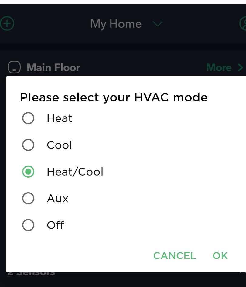

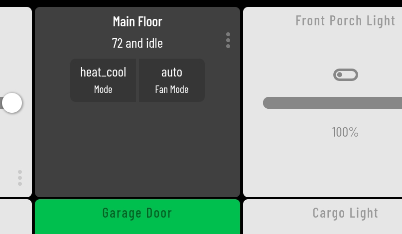

When I use Heat, or Cool as the settings, the setpoint arrows show up fine. Cofirming the only issue is in heat/cool combined mode.
Perhaps we should put a request to change the HE tile behavior so that it recognizes "heat/cool" as equivalent to "auto" and allows for the setpoints to show? But the issue with that would be trying to map every unique device. So, it might not be feasible.
Heat Only
Heat/Cool
Native Ecobee Options
