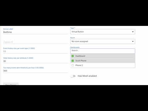

Anyone seen a behavior where you add a device to an additional dashboard, hit save and it does not save the additional dashboard permission? You can see I checked the box to add it but after I click save it goes back to only dashboard being checked.

Well let's see where this takes us... on 2.3.4.125, I get the ability to add another dashboard... In my case, the addition of the "Dashboard" dashboard ![]()
It feels like a bug, but I'm so new at HE I'm not sure of myself. But when the software lets you select it but doesn't save it that feels like a bug.

I tried it on multiple devices and safari browser same behavior.
