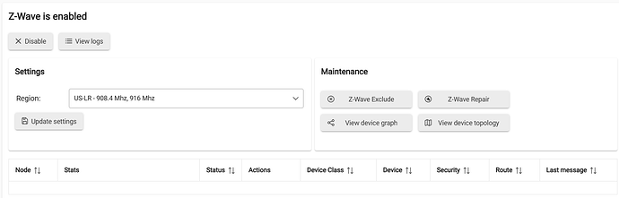

On the new hub Z-wave is enabled and set to the right region. There are no devices listed. Devices were within 3 feet of the hub while trying to pair, so they were in range.

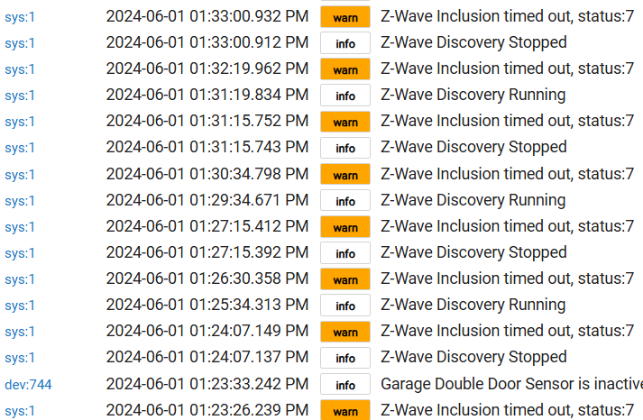

Here are some logs

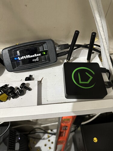

Had nothing to do with the power. It turns out that the LiftMaster gateway was interfering. I moved it away and things started working again.
