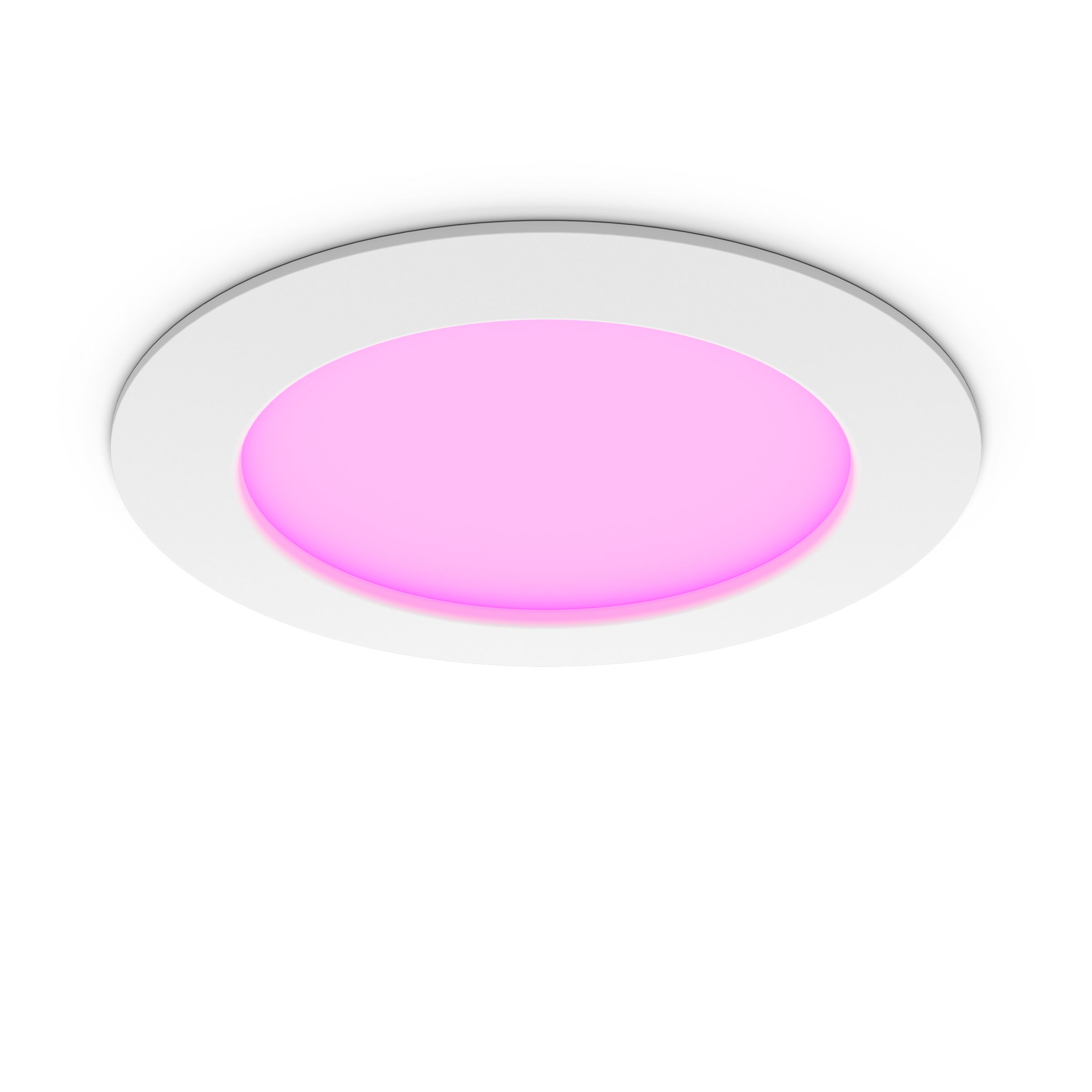

Got an email this morning, looks like Hue introduced something that may work. But it's not cheap.
Interesting. I was going to suggest Philips as they are in my experience by far the most reliable. (Like Hondas and Apple products, they "just work".) But they're pretty deep and wouldn't work based on those pictures. But those slim ones might. Looks like the control box is a separate piece, though, and you'd still have to stash that up in the ceiling next to the light.
