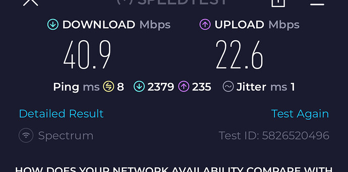

Here is the test I just ran on WiFi from my phone. Again supposed to be 800gbs

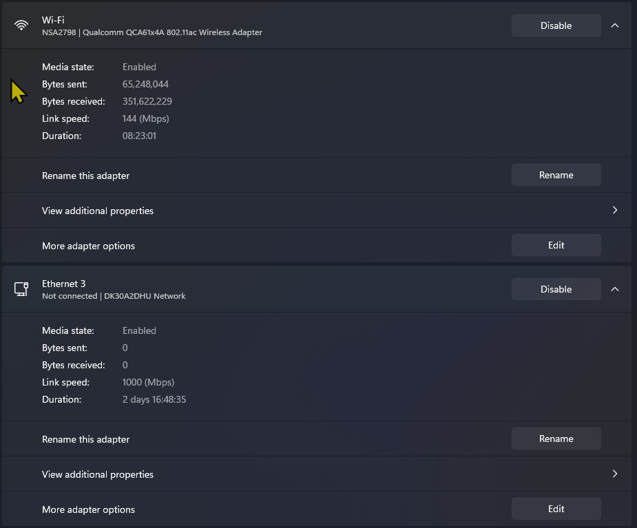

How do I determine the speed on the network card in my laptop?
Windows 10 or 11?
11
Right click on your network icon and open network and internet settings..
At the bottom click advanced network settings. Click your ethernet adapter... Should say link speed 1000mbps

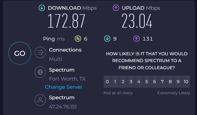

Here is the speed test with the ethernet cable connected to the router"

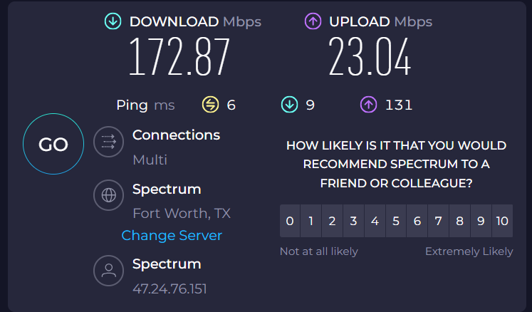

And connected to the switch:

What about if you plug the ethernet directly into your router (reboot before test)
That is the first one, but I did not reboot ...I also tried directly into the modem, and couldn't get a connection. seems weird
