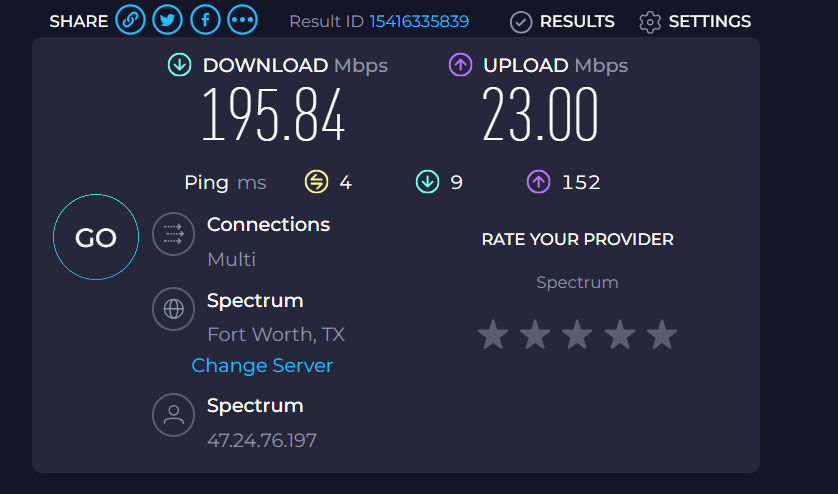

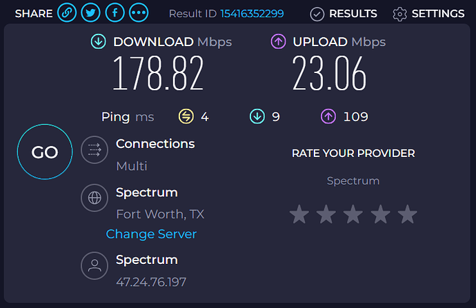

It shouldn't be. We are on Fiber with Spectrum, the network was just installed in 2019, and we were supposed to be at 800Mbps from the start. But i don't think we have ever been anywhere close to that speed. As I said I tried to challenge them a few months ago and they said it was the computers were too old. but I think we have now established that isn't the case.

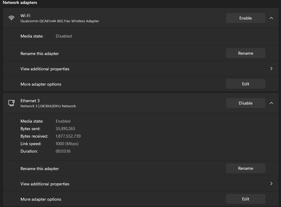

Connected directly to the modem, after shutting the modem down (unplugging it, there's no switch) and rebooting the laptop.
Slightly better, but still significantly less than what we should be getting.
And connected to the switch off the router (because I have to to be able to access my hubs)

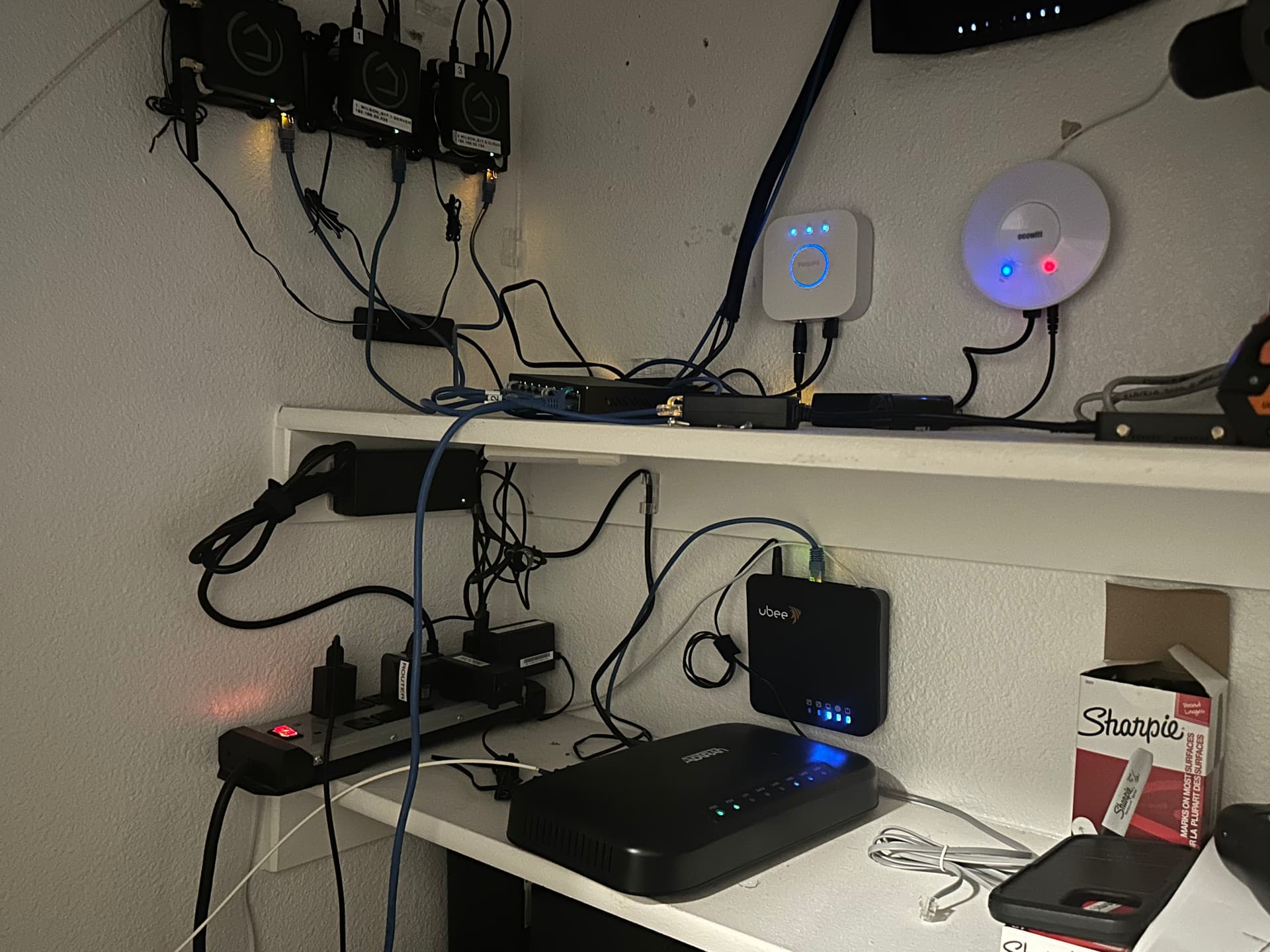

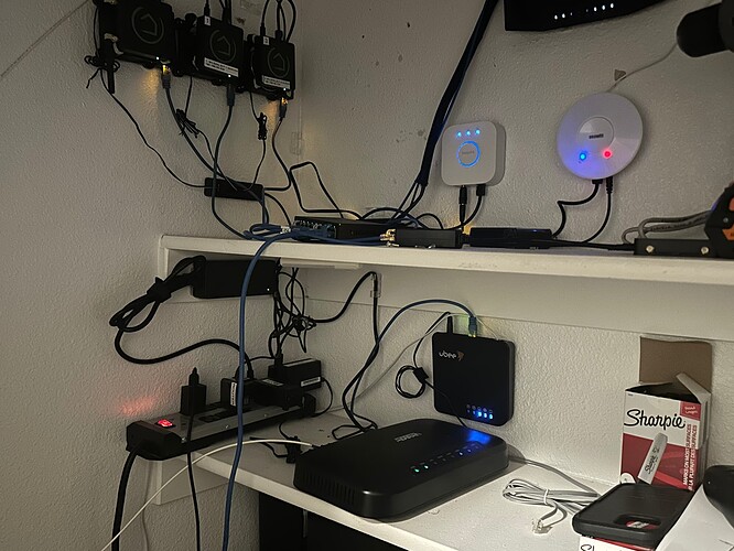

I used that yesterday morning. The tests I did last night were on the regular Speedtest.net. That spectrum site says the test is provided by Ookla, I have no qualms with setting it back up directly and using there “own” site just to document it. Funny thing is when I connected directly to the modem it took it a few minutes to recognize there was a connection. I’m debating if I need them to come out again, I might just have them move the modem to a bette spot or just mount it. Right now it’s just sitting on a shelf. I’m always afraid of braking the fiber cable.
It’s a bit messy at the moment. But the modem is sitting on the second shelf and the fiber cable is just sorta loosely hanging in there. They were lazy when they installed it.
