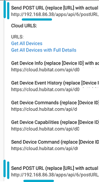

Speaking of the Maker app, has anyone else noticed that identical text for POST URL appears under both Local and Cloud? Wonder if that's a typo (copy/paste), or intentional (i.e. no cloud-based analog). @gopher.ny any insights?
