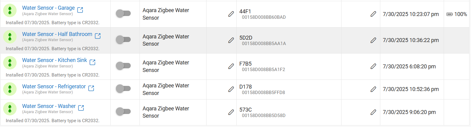

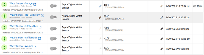

Yes, I noted the dates that I installed the device and will note the dates that I install new batteries. Unfortunately I just found out I have bigger problems. You can see in the screenshhot that 4 od 5 of the Aqara sensors are not reporting the battery levels at all.

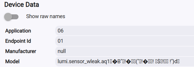

I do intend to use device activity check eventually. But right now I'm switching back to the Zooz ZSE42 sensors. I just don't trust the Aqara which uses a non-standard Zigbee implementation. Look at how the model number is reported below.
There's an example posted right above your post.
Probably just a font that isn’t displayed correctly. Maybe Chinese characters.
