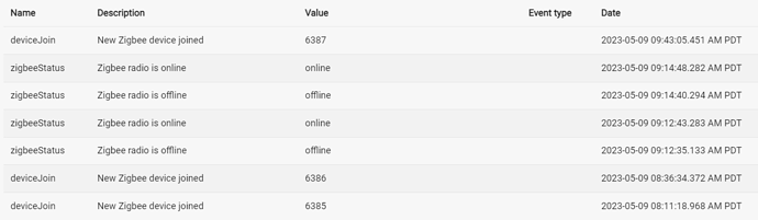

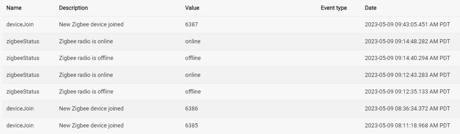

OK...reporting back after changing Zigbee radio back to 16 yesterday. Haven't had a device fall off since the power change from 12 to 16. It's only been about 24 hours or so, but a couple of my leak sensors at different ends of the house had been falling off pretty frequently so this could be signs of improved stickiness of my devices. But still early days after the change yesterday.
No Zigbee radio reboots since yesterday morning when I was doing a bunch of pairing activities trying to re-join a couple devices that had fallen off before the power change back to 16.
