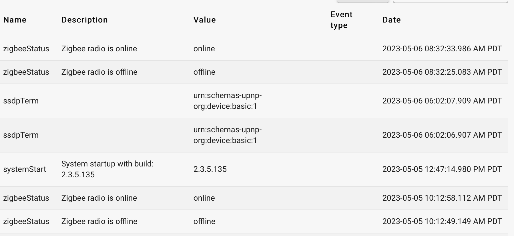

After being pretty steady for the last couple of releases, I'm getting daily zigbee off/on events again. (sigh)
But "ssdpTerm" is a new one on me. Can anyone tell me what this means?
UPNP reference seems to indicate that a LAN/Network-based integration may be involved.

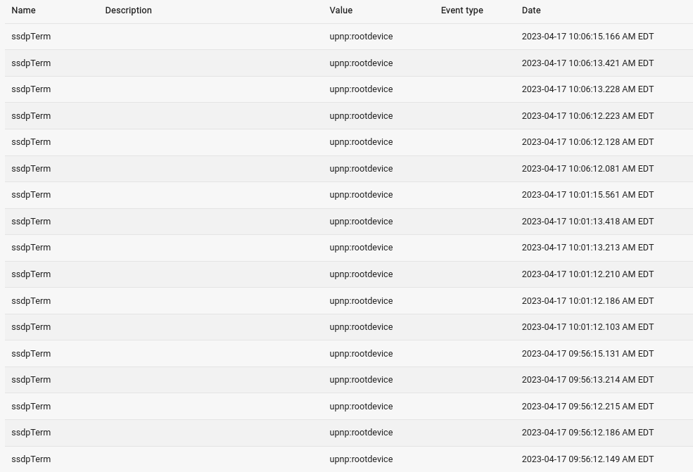

Have you searched the forum for ssdpTerm? That'd be my first step.
Does this help?
Yes, thanks!
I'm guessing it was recreating the HomeKit interface.
(And sorry. I'm usually better at searching.)
Fwiw, in my case it was the Advanced Hue Bridge Integration. There was a bug causing it to keep running discovery on a schedule. Armand pushed an update out this morning that fixed it.

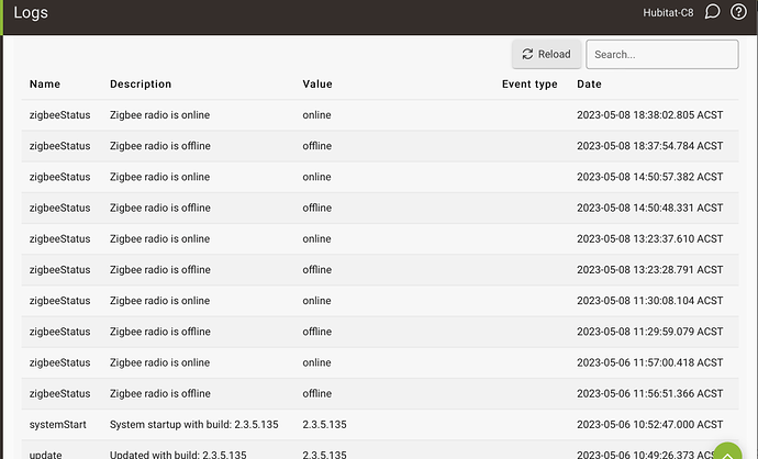

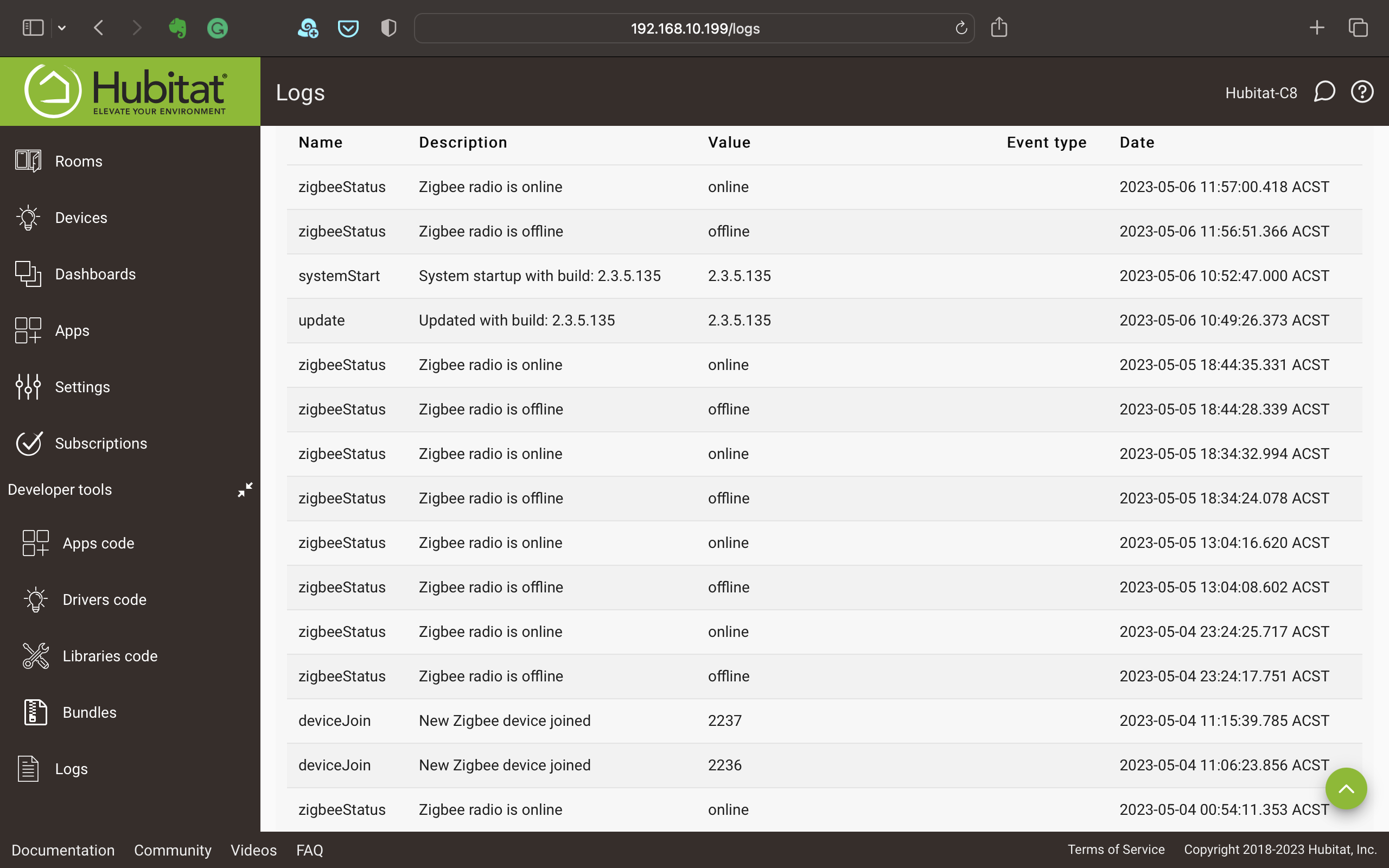

Hi All,
My hub is experiencing the same issue as shown in the attached snapshot. Hopefully, the new updated fix it.
Any suggestion would be appreciated. Thank you.
I've seen significantly fewer radio reboots w/.135. HE staff has said that having a reboot immediately after an update is not necessarily an indication of a problem, so hopefully your hub will also be calmer on .135 over time.

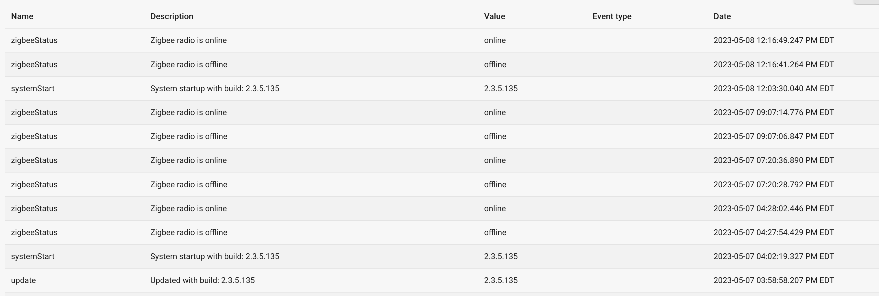

Lucky me:
it started again after the last update
