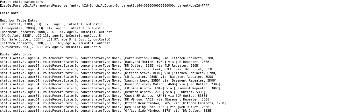

Looking in my route table, most of my devices are routing thru them, so it would make sense they bring the mesh down when they go. Den outlet, LR Repeater, and Basement repeater are all Tradfri devices
