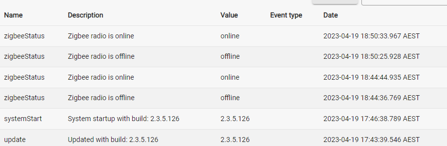

@mike.maxwell Updated to .126 about an hour ago. The zigbee radio has gone offline/online twice already since then. Doesn't look like .126 helped.
