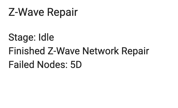

I'm on 2.3.7.145 on a C8 hubitat. I've never had issues adding zwave before. I went to settings, tried a zwave repair and got:
but again, other zwave device added fine. So I'm not sure what to do. The zwave topology has lots of red and blue rectangles, and the device graph shows lots of repeaters, one hub, and lots of devices.

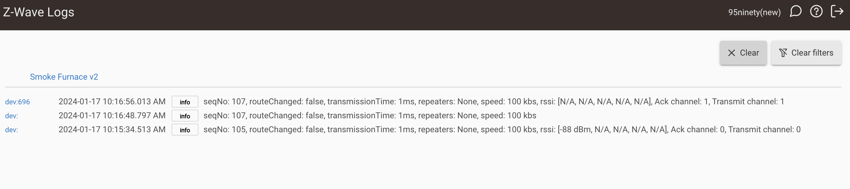

Open the Zwave log and then in another tab start the inclusion.

Thanks @thebearmay for the tip on the log. I did a few factory resets and two full inclusion runs and only saw this:

  • I have run the "zwave repair" and had one failure (5D) but all other devices have a check mark for status. (below is the one failure device which I'm not sure what I can do with)

That device you show there is a ghost node, it is not attached to a device on the hub. It is showing 19 neighbors so you will have a hard time getting rid of it. If its the only one like that it is probably not causing too much trouble, especially since you can include other devices.

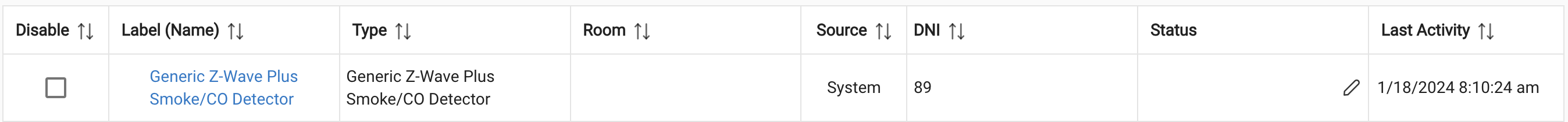

Oh nice! I never knew about this feature in Hubitat. So I just did the SmartStart button, qr code read in fine, it was pending for ~1min and then said "included, Node: 0x89". I gave it a name, and saved.
Then I went to the list of devices on the hub and was expecting to find it, but didn't. Is there another step to complete this flow?
Oh, I take that back. It worked, but the name I gave it in the app did not seem to carry over:
Thats normal. To find it I usually go to Z-Wave details and then it will be the last device at the bottom.
