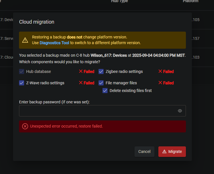

The current C8Pro is actually the 2nd replacement (and the most promising of the two) but still not working. The original C8 Pro, the 2nd (warranty replacment) and now third (also warranty replacement) all seem to have the same or similar issues. The only issue I can come up with is that the source C8 does not produce "migration ready" back-ups, meaning its not listed under migration ready . It doest produce a cloud back up, and I have been told numerous times that does not mater, they are the same thing. If thats the case that also eliminates that hypothesis.
and just tried again

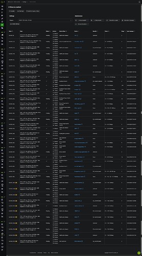

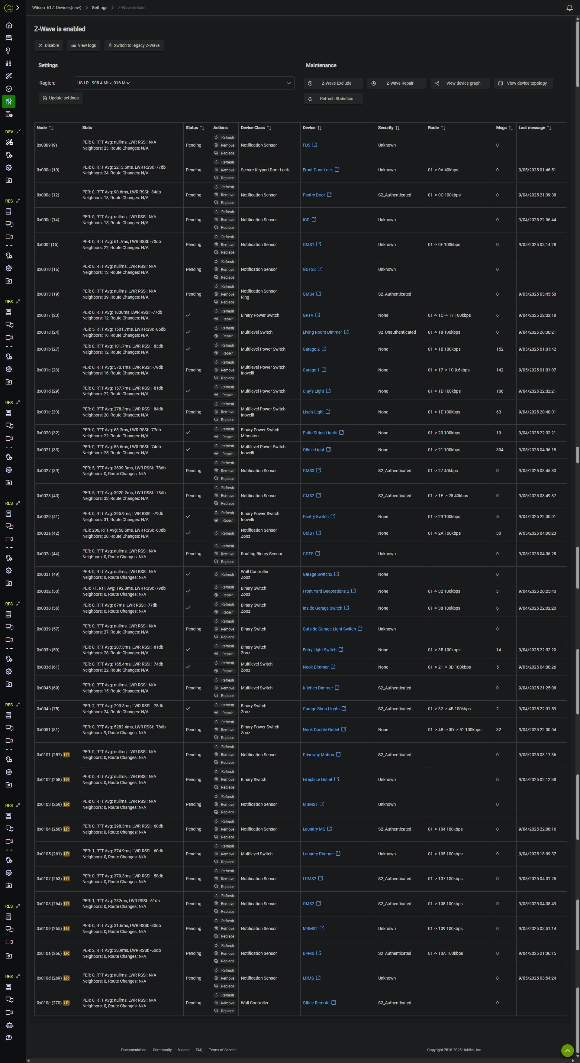

Since I couldnt full reset the hub , and could not re-do restoring a back up , I figured I would just simply try and turn the radios back on, switch to Zwave JS and see what happend. I did this at about 5:00 lastnight. As of 04:00 this is what I have. Not that very little is actually responding.
Z-wave details

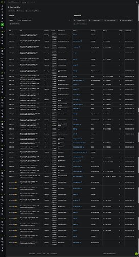

Before I started the migration, after I did the cloud backup, I shut the old hub down, so it was offline when the migration happened. That being said. I have had the Pro on line with the radios shut dowb after the questionable migraton for a couple so that hubitat could look at the logs if they needed to. I guess that could have been contributing to the old hub becoming unstable.e.
Here are my zurrent Z-wave details as of this afternoon, this is about 24 hours out
