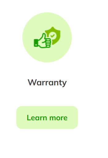

It looks like the support site redirects to this community forum when I click the link to ask a question there.
Scroll down on that page until you see the "Warranty" section, click on that.
