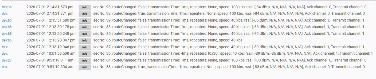

Oe thing I didn’t mention…when monitoring the zwave logs I notice that frequently a device with no association keeps coming back. For example see the following log…devices listed as “dev” have no assocation.

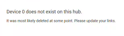

When I click on info I get the following
It almost seems like a Ghost node…but in the zwave details page all looks good. no blanks.
any thought on this?
