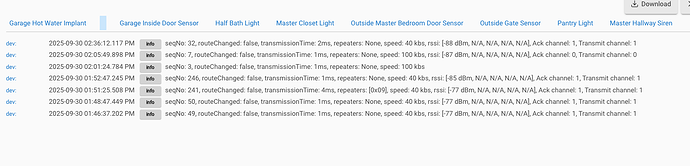

Update on Z-Wave logs. I do see logs - but only when devices are switched on or off by HE. There do not appear to be any status-type messages.

Correct, on ZIP those logs are nearly useless.

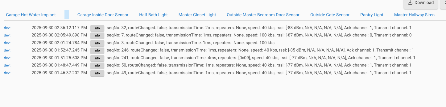

Why do I have a device in ZW logs that has no name or number? Just says dev: and is represented in device list at top as a blank space. Am I onto something else wrong?
Thats normal, the first log from a device will show like that then the next ones after that will have the device. Known issue with the ZIP logs.
