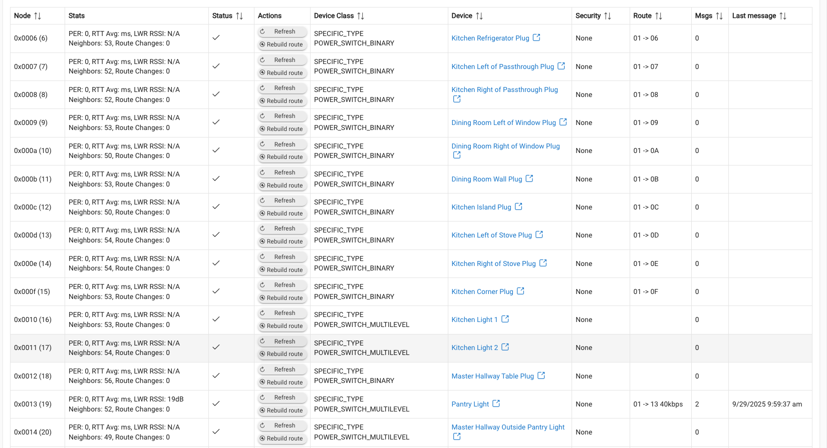

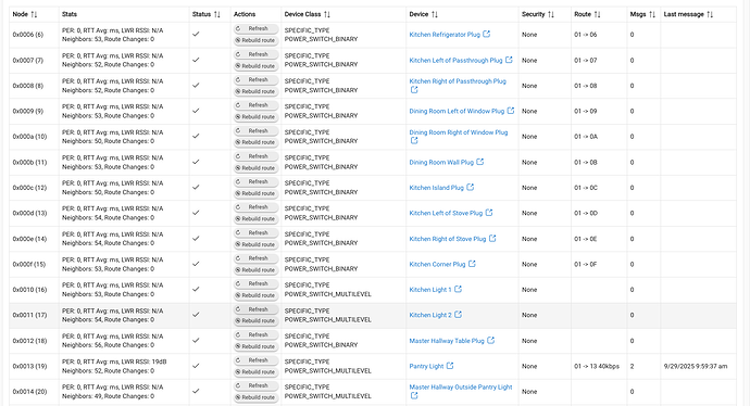

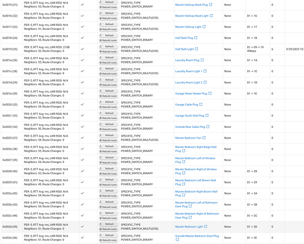

Might be good to look at that zwave details after the hub has been running a for a bit. Refresh the stats with the button up top then look for devices with a lot of messages. That might help narrow it down.
There is also the possibility that a device is going haywire and sending out garbage transmissions, which clog up the mesh but wont get counted by the hub. Those are much harder to track down.

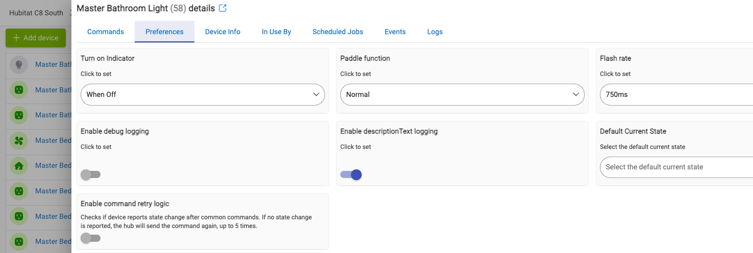

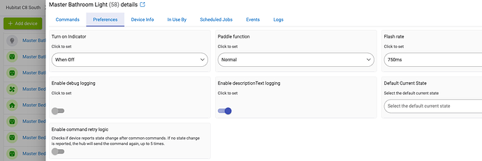

Many (all?) plugs/outlets, as well as newer switches have power reporting capabilities. Absence of adjusting the power reporting parameters in a driver (especially a custom driver) doesn't mean the device doesn't send power reports to the radio, which could result in overloading it. Generally, built-in drivers allow adjustments to the reporting param.
Most of my Z-Wave outlets, switches, dimmers, and fan controllers are GE/JASCO from 2016 and use the default/generic built-in drivers. I also don't see anything in state variables about power.
Are there "better" drivers I should be using?
With these drivers I don't see anything in Preferences that I can change...

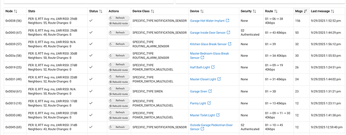

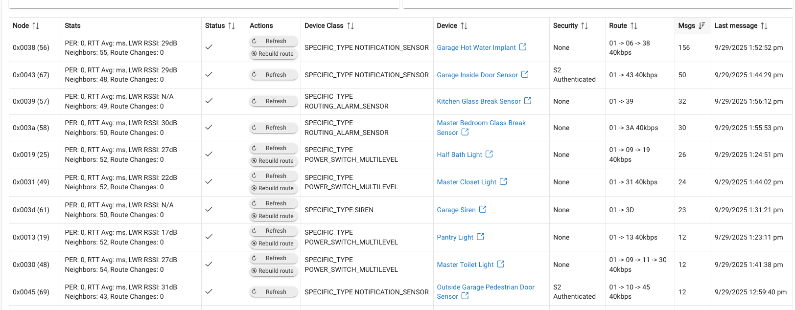

Thanks for pointing me specifically where to look - not sure I found any problem though. 156 messages isn't "high", is it?
Nope.
But garbage sent by a malfunctioning device will not show up here. It may show up in your z-wave logs.

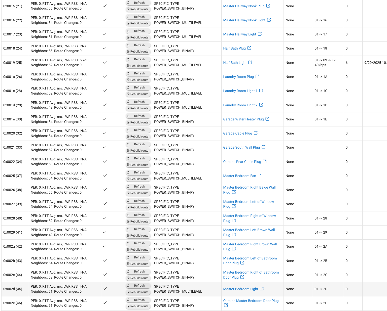

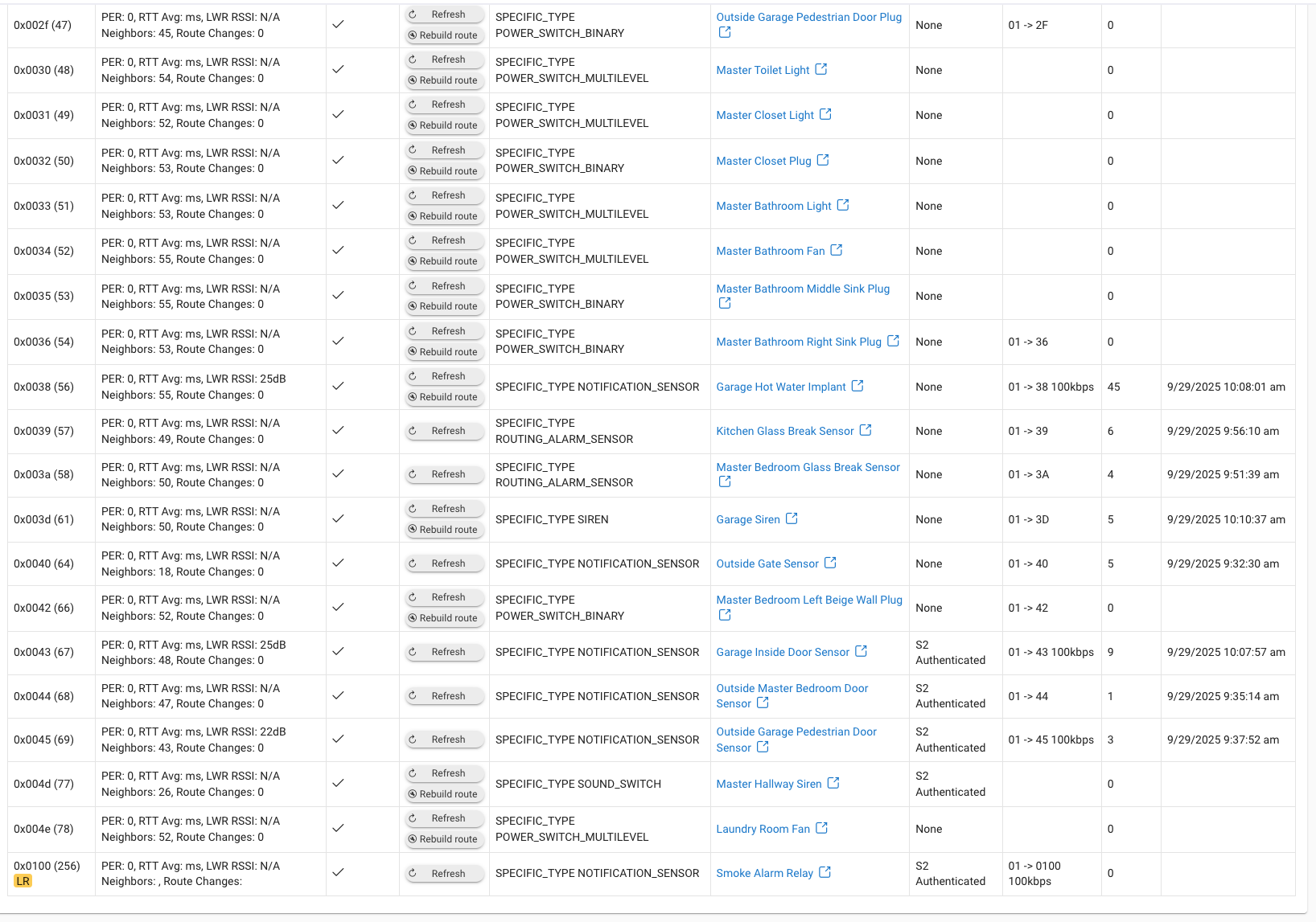

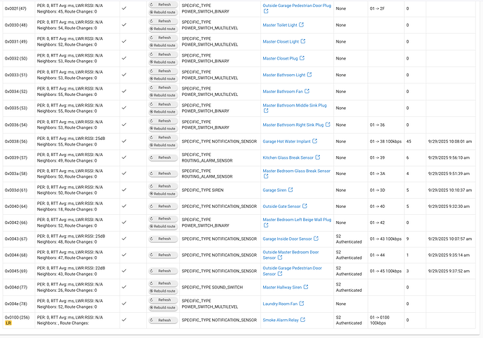

Interestingly, from my post with the messages - the worst "offender" for automation not working is master toilet light - and it has the most hops. Just tried a rebuild on Garage Hot Water Implant (highest messages) and it failed. And tried Master Toilet Light - it succeeded, but kept same route - the switch is 25 feet from the hub. hmmm.
Did you actually refresh the stats (then refresh the page)? The RTT is all blank and they are showing 0 route changes.
If message count is not showing any outliers then next I would look at the RTT and Route changes.
I had only refreshed the page. Tried both now - still about the same.
I was looking at RTT and noticed most are blank or very small ms - but one was 656ms and another (that new siren) was almost 65000ms - wth? I did a rebuild on it and now it is not responding. Timing on "issues" is close to when I added this bugger. I just removed it for now.
