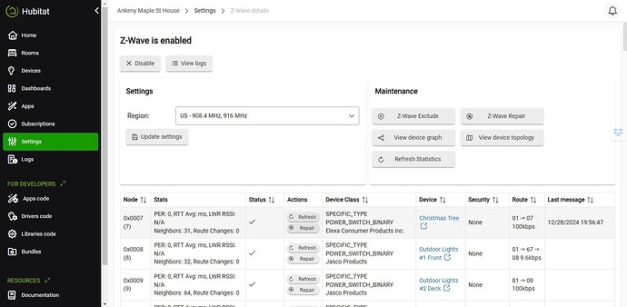

Post a screenshot of your entire zwave settings page.
This is just the top of it. You want the entire thing posted?
Yes, with at least 12 hours since last reboot and click the refresh stats button before getting screenshots.
Thank you. Last reboot was 1807 hrs today, so will post tomorrow

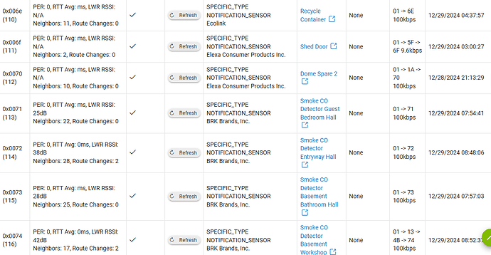

First 5
Second 5
Last 1
Did you press Refresh Stats right before the screenshots?

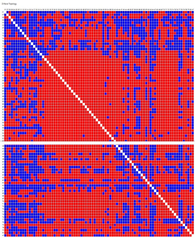

Also post the red/blue topology map. I have a hunch.

Yes, I did a refresh before capturing the screen shots and posting then this morning. After posting them I started another round of testing and it appears things are again magically working,,,. I have not tested 100% but I have checked most items and they appear to be working. Another nugget for the symptom pile: Last night I also could not go into "devices" and turn on or off anything, and I could not use the dashboard buttons to turn things on or off, but as explained before, if i physically clicked on the switches I could turn everything on or off and the status's would update on the dashboards. They would not update on the devices page for each device, though. I have no explanation. I hope you or someone here can. Weird. Here is a collage of the topology,

Topology looks OK, not great, but not showing the issue I was thinking you might have. Looks like you have a spread out mesh which is fine especially if it was working fine before.
