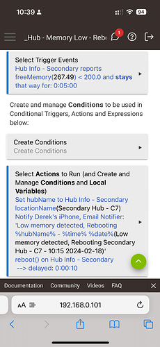

I'm trying to copy your rule. How do I Set hubName? Can't figure that part of the actions out.
Howdy, you don’t need to, that bit of the rule is grabbing your hub name from the hub and storing it in a local variable. First time you run the rule it’ll populate.
Ok, I was able to figure out everything else on the rule and get it plugged in, but couldn't figure that part out... I just ran the rule and my hub is rebooting... let me see what it looks like when it comes back up.
also i tried to download and import your rule, but that didn't seem to work.
that didn't work... hub rebooted cause i ran the rule, but still don't have the first line Set hubName under actions.
This is my rule
Strange, I just exported the rule from RM, I wrote the rule that way because I have multiple hubs and this meant I could just write it once.
You can just modify the local variable manually if you like.
ok, I'll try that... :slight_smile:
I just checked and downloading and importing my rule from GitHub does work. I’m wondering if your browser didn’t save it as a raw text file.
Not sure, I went to raw text and copied it into a file then tried the upload... either way, i see why you created it with the naming variables. I just replaced that part and wrote the rule specific to each hub. curious to see if this will help with my lockups. i'd rather they reboot when i don't need them... :laughing:
Sorry I didn’t see your rule in the earlier post, it doesn’t have the hub name because you haven’t duplicated that part of my rule.
I’m pulling it from hub info’s locationName and feeding it to a local variable called hubName at the start of the rule.
Just right click anywhere and select “save as” or “save page” depending on the browser.
