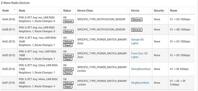

I'd like to get the garage door monitoring working again, but I recently read this on the Zooz site: The ZEN16 MultiRelay is NOT a reliable solution to track the open/close status of your garage door. I can't imagine why that would be. I'm also confused by what appears to be placeholders in the device list from the ZSE43's. Is that an indication that I didn't exclude them properly?

The entries with the "Discover" button are ZW ghosts - you need to get rid of those, Those entries don't have any neighbor values >1, so you should be able to remove them without a z-wave stick. Check out this thread for more info.

I was able to successfully remove the ghosts using the Refresh/Remove buttons. Thanks for the help on that. I will move forward on getting some door switches and installing the ZEN17.

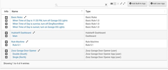

My intent is to display the opened/closed status of each door and have a button to open/close each door on the dashboard on my iPhone app. Do I just include the ZEN17 like I would any device? I recall reading something about a garage door app, do I need that?
Yes, you'll need a garage door app to tie all the pieces together for a dashboard tile. The Zooz garage door app is very good - that's what I use.

It seems you have a couple of ghosts from the tilt sensors.
Sounds like you maybe just took the tilt sensors off and took out the batteries or something.
Maybe if you would put the batteries back it they would come back, you could discover them, and then exclude them.

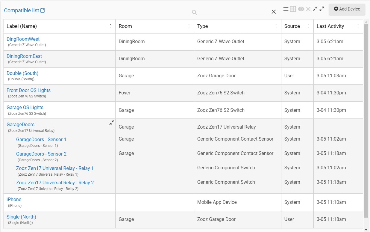

I've completed the installation of the ZEN17 and the magnetic door switches (had to wait for the 30°F heat wave). I've also installed the driver/parent/child apps. The ZEN17 is currently powered down, as I initially had a problem with one of the outputs turning on and screwing up the operation of the opener, even though I haven't added it to the C7 yet. I suspect that's due to some default settings in the ZEN17 that I'll be changing once I get it configured.
I am confused by something in the Zooz instructions however. After adding the ZEN17 to the C7 and changing a couple of R1/R2 settings, it says to click on "Create Garage Door". Do I have to do this for each of the (2) doors, or does this cover both channels of the ZEN17?
I do believe you have do that for each.

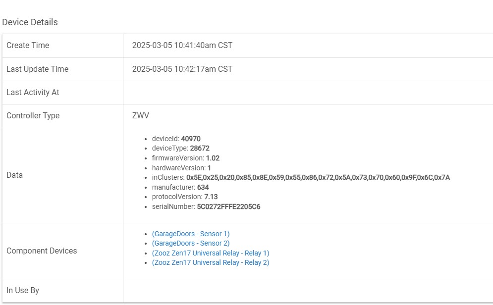

I now have the ZEN17 included, but things aren't going very well. If I click on Double (South) or Single (North) there are open & close buttons as well as an indication of the magnetic switch input status. Everything seems to be reversed (button operation and open/close status), and I don't see where you can reverse the state of the inputs. My ZEN17 is V1.02, which from what I've read, is very early and may be the problem. Any suggestions?
