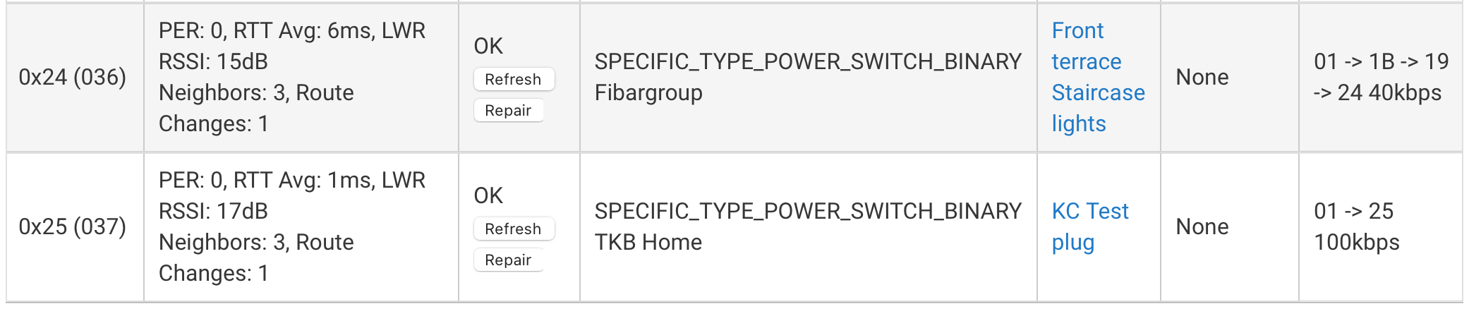

In a browser go to yourhubip>>settings>>z-wave details and screen shot the whole thing and paste it here (take multiple screen shots if it's large) Use windows snip tool.
Yeah you have 6 ghosts, no wonder nothing is working correctly. You need to remove them so your mesh is clean. Click the refresh button then when it shows click remove and wait. A prompt may come up asking for force remove, say yes. Another issue you have is all those fibaro sensors pairs as S0. That's an extremely chatty protocol and those devices should be re paired with security. (You may need a z-wave stick to do that)
The reason you are having issues is because of the ghosts. Do you see all those devices with DISCOVER next to them and nothing in the route column? Those all need to be removed. Your mesh is a mess
