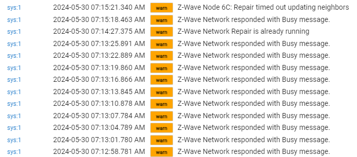

I also noticed a lot of timeout warnings in the logs from running a repair...
That probably doesn't bode well for the mesh self healing.
I will take a look. Thanks!
Yeah any time you are getting a bunch of those Busy errors shut down the hub and unplug for 30 seconds. It is pretty rare to see on a C-8 but there is something going on with the new Long Range support that can make this come up when trying to clear out dead nodes.
