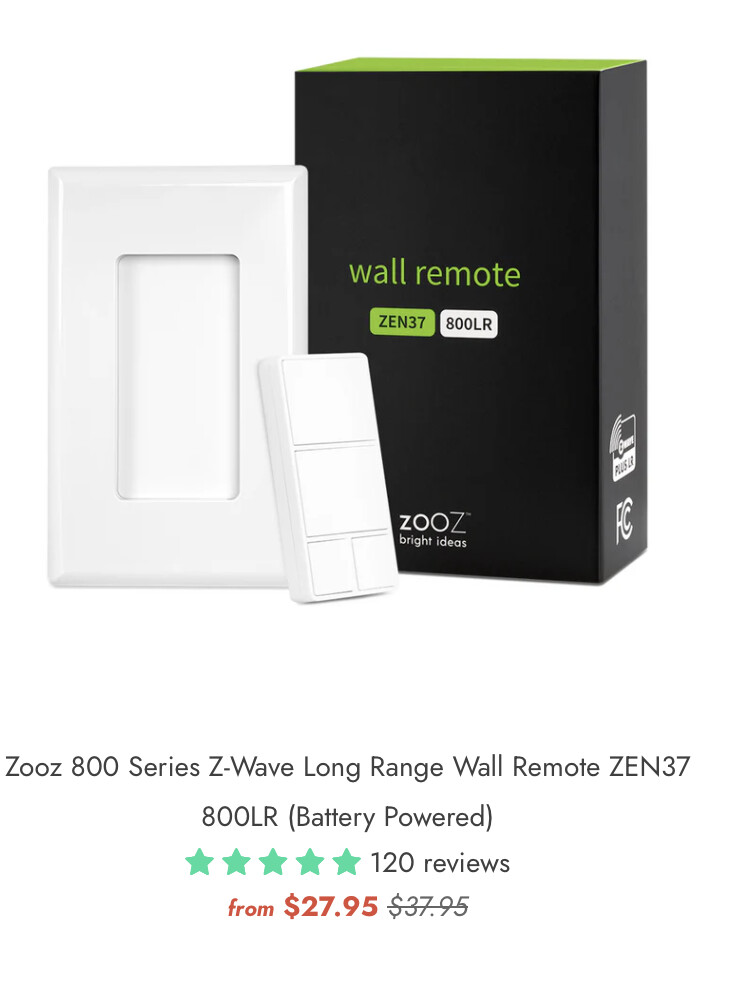

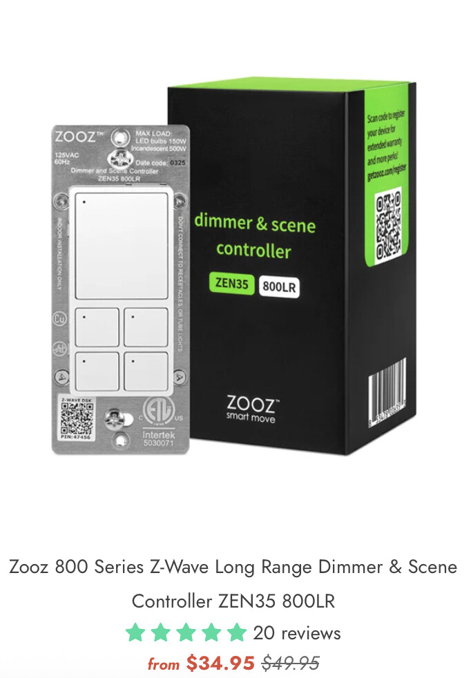

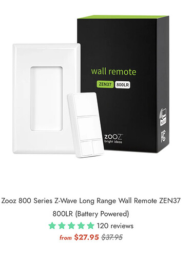

How about this dimmer/scene controller:
Or this battery powered scene controller:

the above seems to be true for the devices @TArman, @velvetfoot mention?! cant i now build my own scene controller with @bertabcd1234 ´s software, by using just a simple button that only needs to be able to send pushed commends?
what is the adantage in using the "dimmer/scene" switches? arent those also just a dumb button to begin with? or does their software give me exclusive capabilities?
