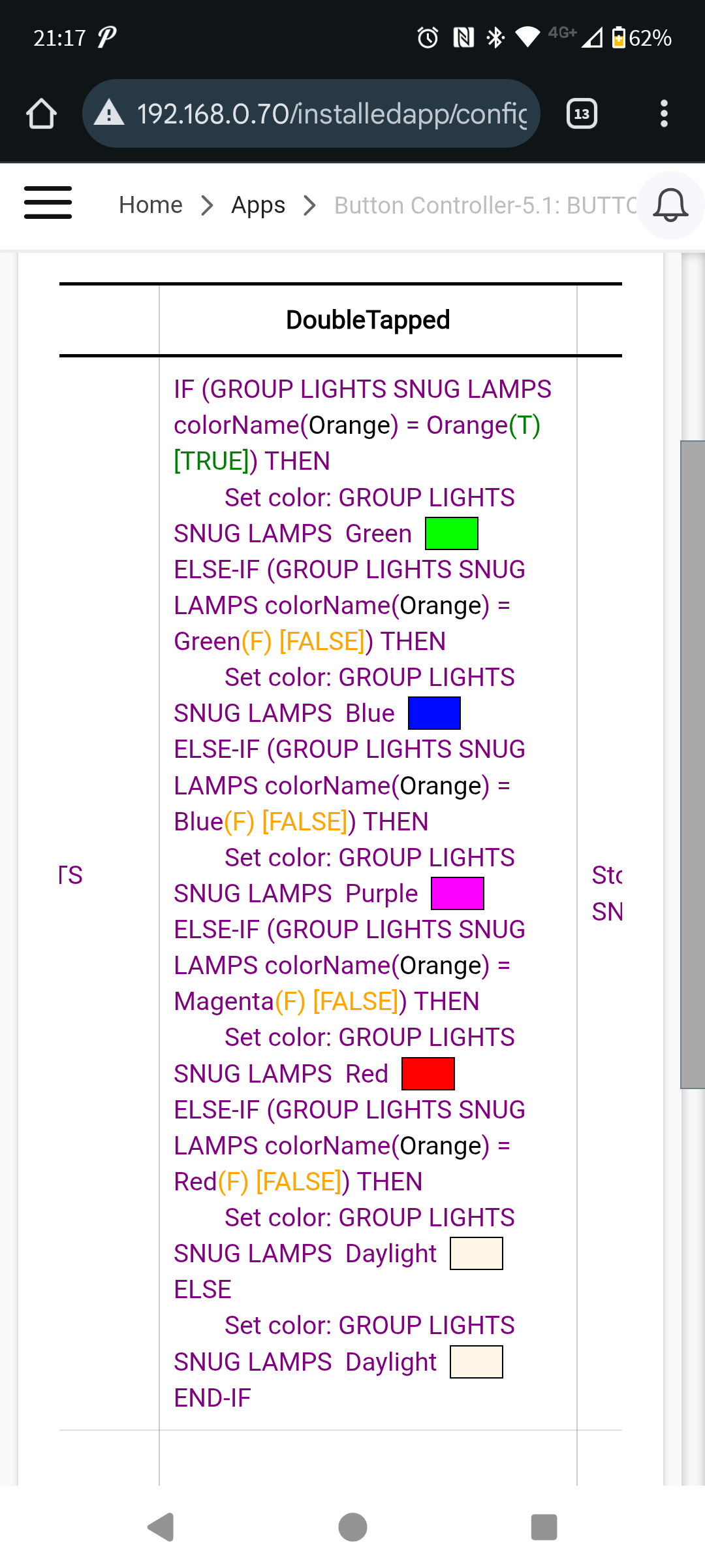

I have IKEA Tradfri bulbs and IKEA sSomrig buttons (sure the button is irrelevant). To toggle through 5 colours, I have this rule within button controller which works hreat but it feels like a clunky rule. Is there a way to toggle through colours without having to define them in a rule. Or is there an easier way of defining the colours without the usage of a dashboard?

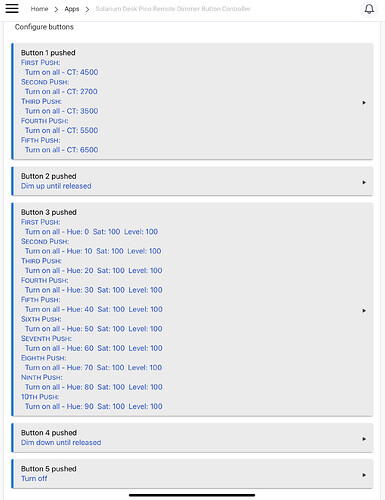

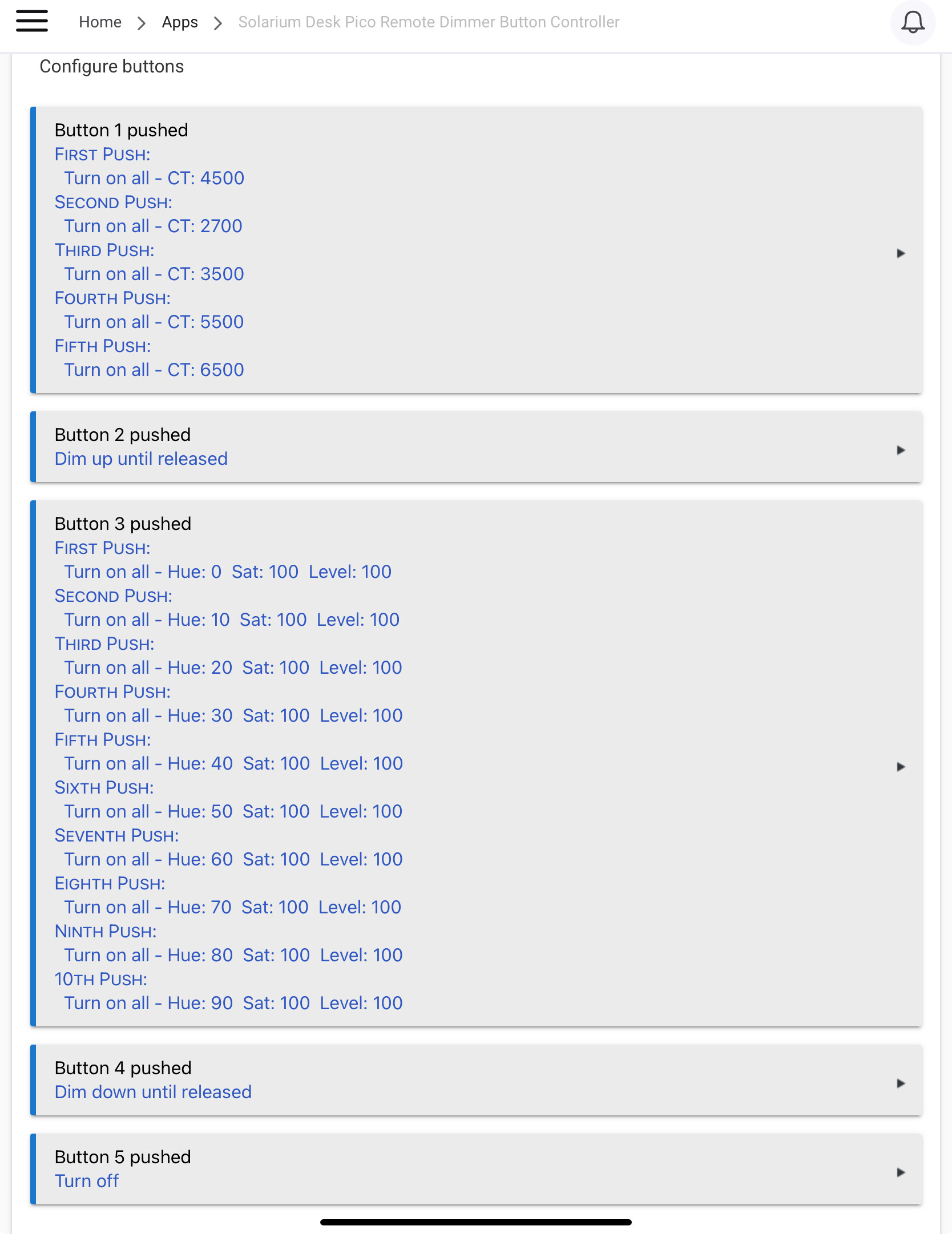

I use @bertabcd1234’s excellent Dimmer Button Controller app to do this:
This is what my setup looks like with that app:
