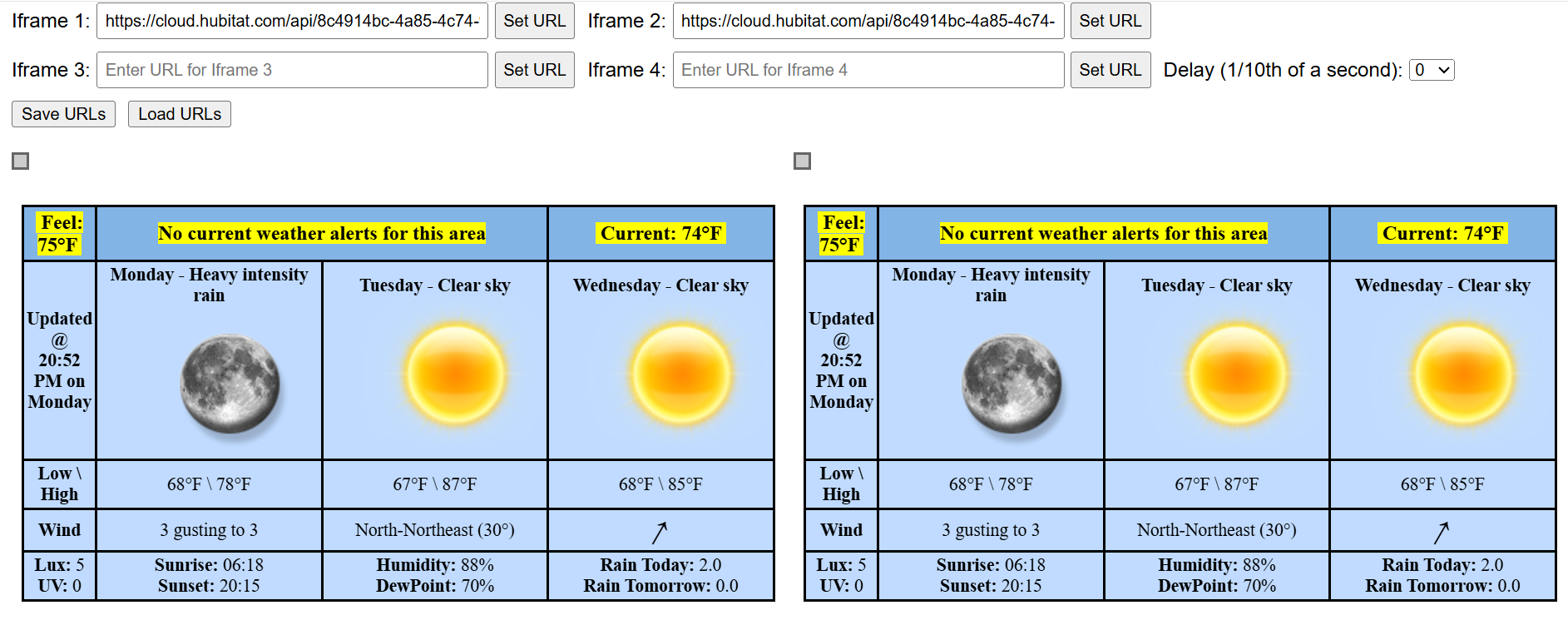

The problem is this. When you load two cloud endpoints into iFrames in short succession you will often get the wrong output being presented. This is how it should look.
If I change the delay to 0 and do a refresh. Now it looks like this.
If I do another refresh it may look like this or some other random variation:
If I bump the delay up to 1 second it will work correctly most of the time and display the first image. I would estimate 90% - 95% accuracy with this level of delay.
