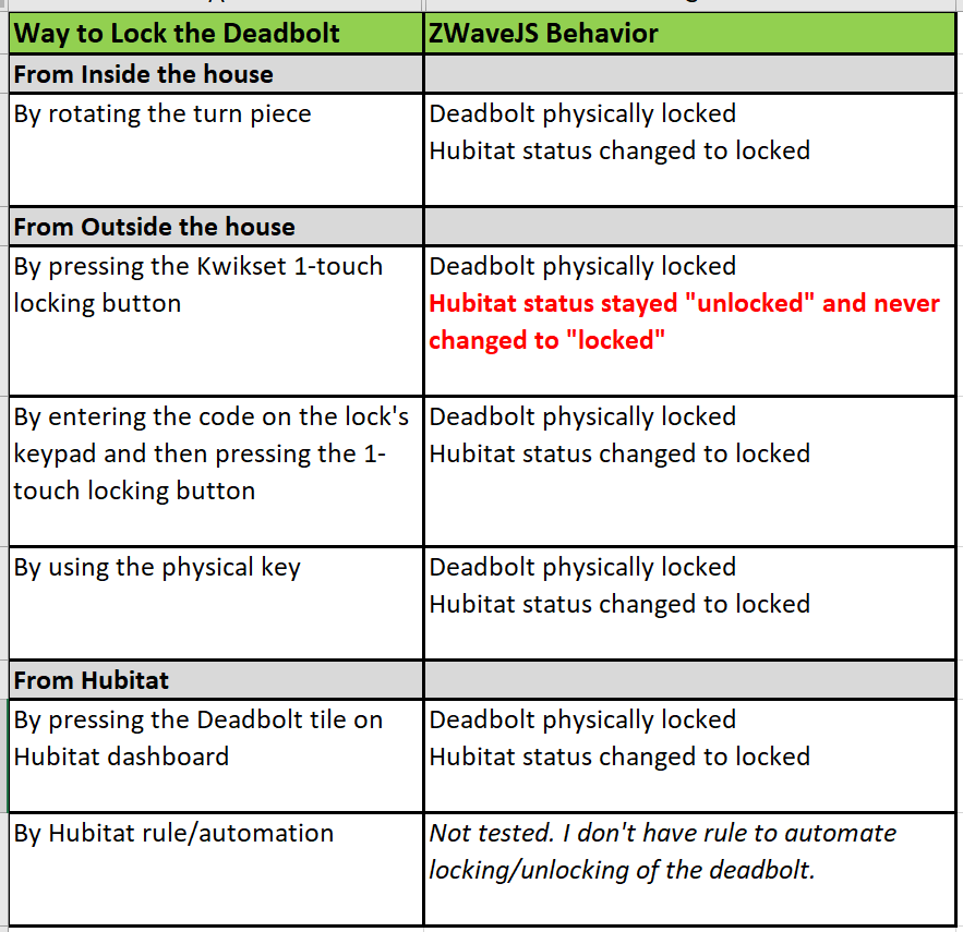

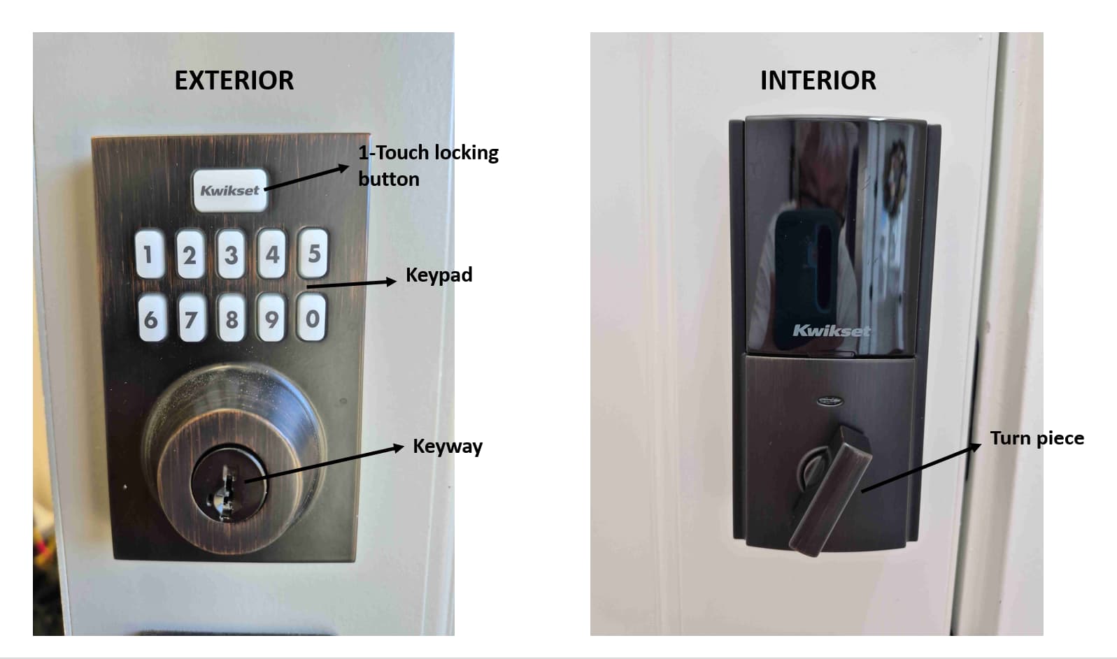

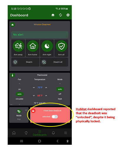

I performed additional testing and found that the issue only occurs when using the Kwikset 1-touch locking button on the exterior keypad. Other locking methods/scenarios appear to work correctly.
I’m attaching a few pictures below for reference.
