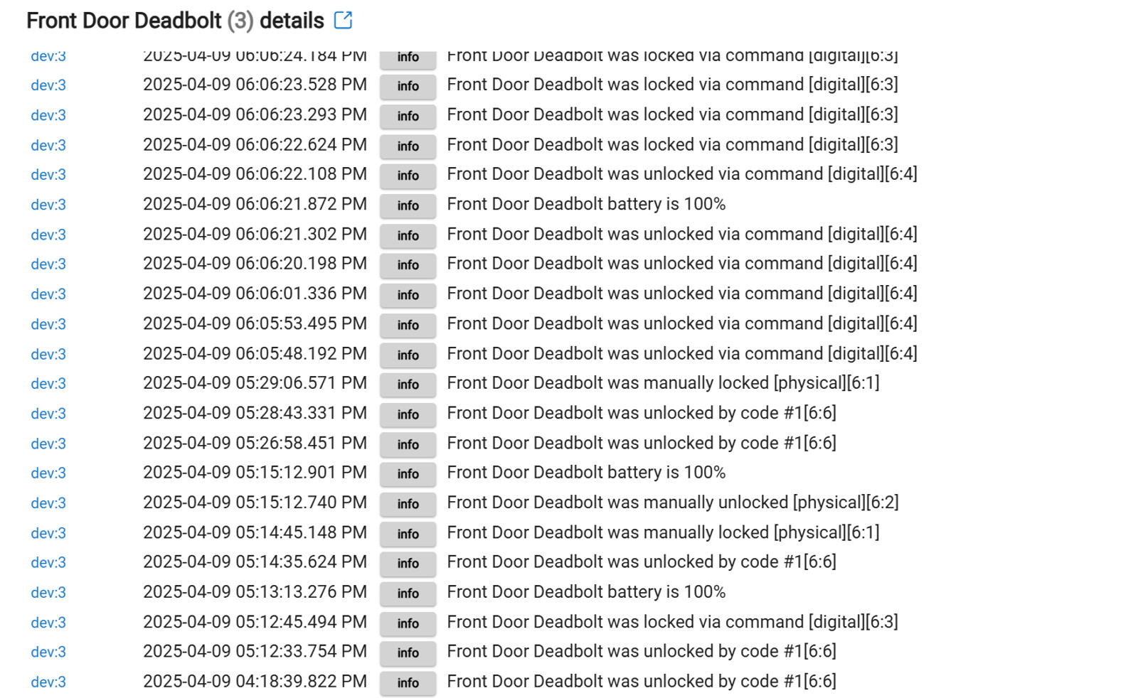

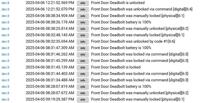

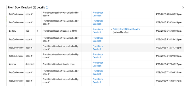

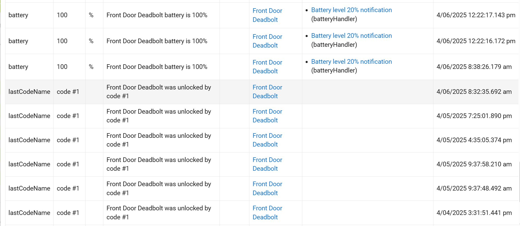

I think the last time it unlocked by itself was 4/6 morning, before I switched back to Legacy Z-Wave. Here are the event logs.
Here are the logs from the Logs tab for 4/6.

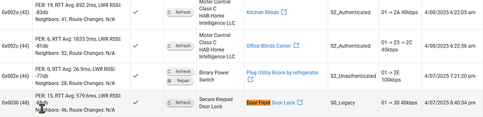

I notice that my Kwikset deadbolt doesn’t have a “Repair” button. The Repair button was there when I used the Legacy Z-Wave (see my original post). Is this normal?

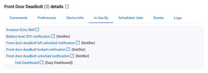

I have setup notifications to tell me when the deadbolt is unlocked/locked/stay unlocked.

That's normal for battery powered devices...same w/my Schlage lock, my iBlinds, and a few battery-powered Z-Wave sensors that I have on ZWJS...they all just have the Refresh button (same w/LR devices, both mains powered and battery, as LR doesn't have any mesh connection to repair):
Turn off Alexa hunches (if it is turned on). You need to do this in the Alexa app, and not Hubitat.
What would be really helpful is capturing one of the "random" unlock events - in the Lock's event log.
I just removed the deadbolt from the Alexa skills. Thx
I'm not an Alexa user, but I think you should also turn off Hunches directly on Alexa as well, unless you like having Hunches on.
I think you can just say something like "Alexa, turn off hunches."
I just told Alexa to disable hunches. They are now Off.
So now hopefully you can get the event that @aaiyar mentioned above so your issues can be figured out.

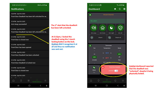

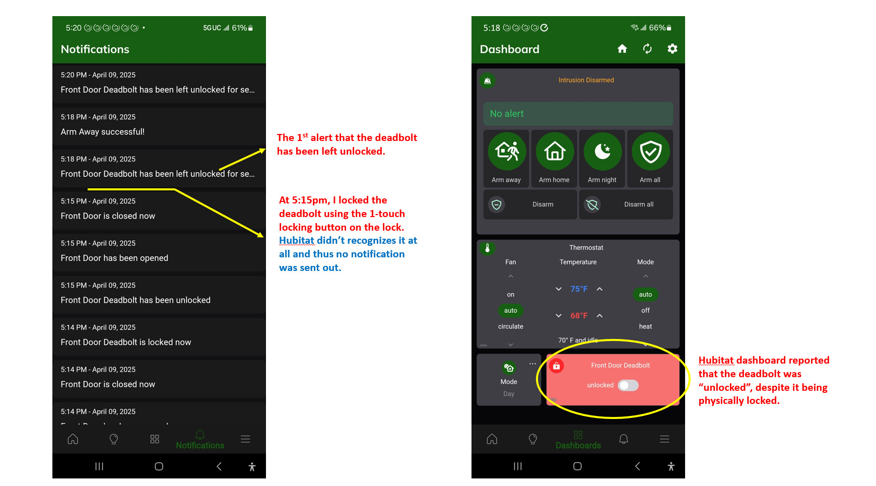

Hi, The issue happened again yesterday around 5:15pm, with a twist. I was able to reproduce it. I also did some experiments and I believe I have narrowed down where the problem is. See below for details.
What Happened:

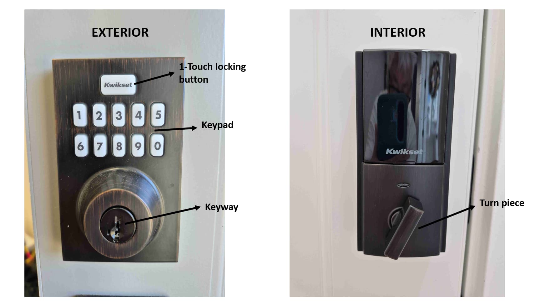

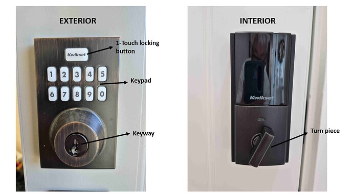

Yesterday around 5:15pm, I took my dog out for a walk, through the front door. I locked the front door deadbolt by pressing the Kwikset 1-touch locking button (see picture below). I double checked that the door was really locked by trying to open it. About 2 minutes later, I got an alert/notification on my phone that “the front door deadbolt has been left unlocked”. (I have a notification setup that would notify me every 2 minutes if the deadbolt stayed “unlocked”). After letting my dog finished his walk, I went back home to check the front door. The front door deadbolt was still physically locked, but the alerts on my phone kept triggering and the deadbolt status on hubitat dashboard showed “unlocked” despite the door was physically “locked”

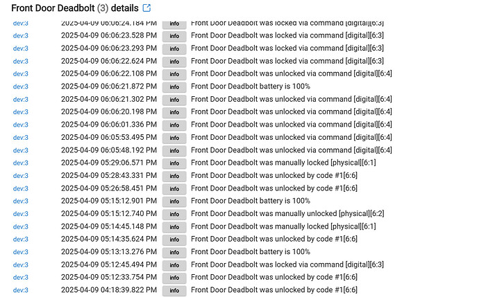

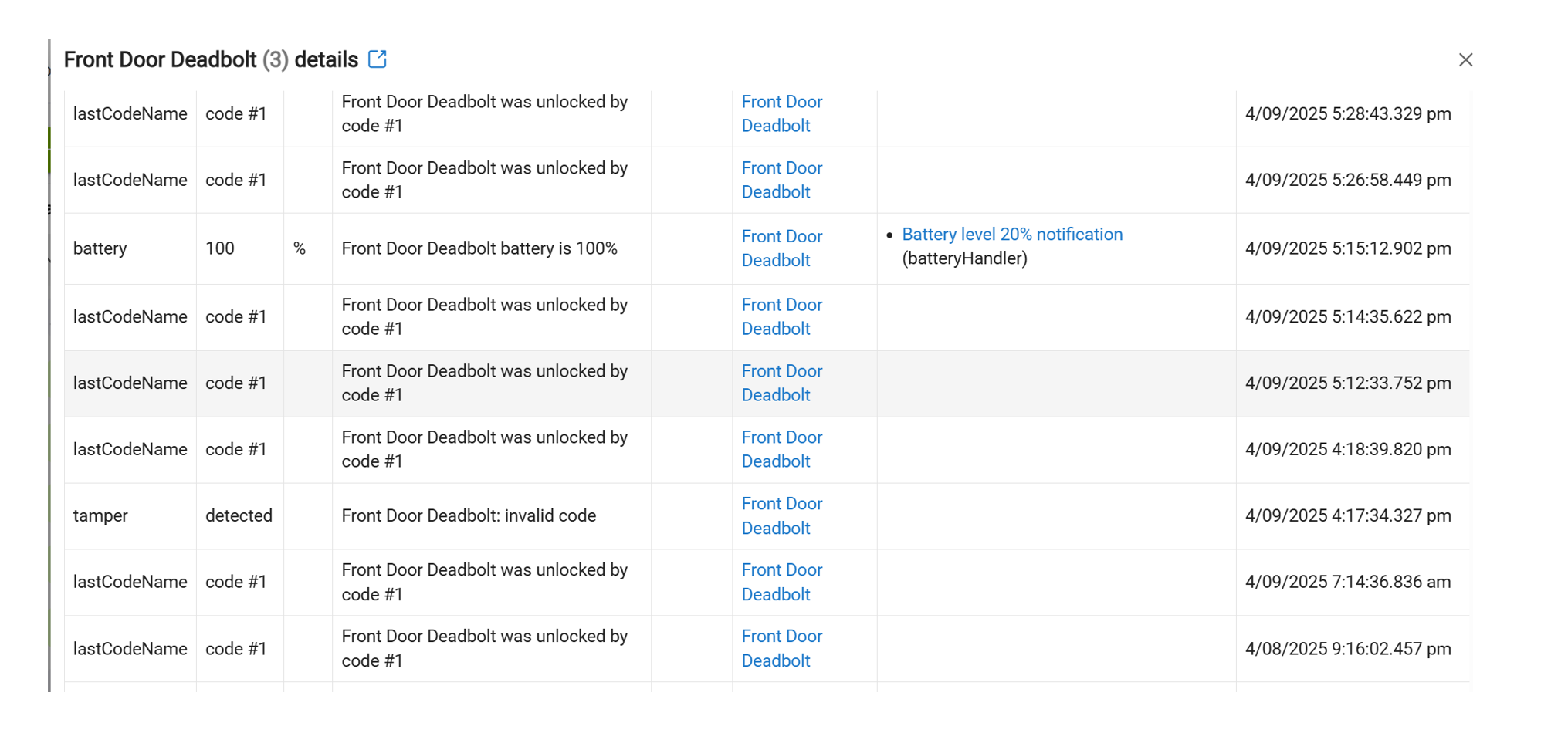

Here is the deadbolt’s events log – it doesn’t show much, if anything.
Here is the deadbolt's logs (from the Logs tab).
Here are the Notifications log on my phone and the deadbolt status on the Hubitat dashboard.
Looking back now, I realized that all the alerts that I got in the past week happened when I was away from the house. When I got the alerts that “the deadbolt has been left unlocked”, I would just lock it remotely from my hubitat dashboard on my phone. I never checked the door as sometimes I was already miles away from my house. I only discovered it yesterday that the door was actually still locked, but hubitat was mis-reporting it as unlocked.

So in conclusion, the problem is not with the lock physically unlocked the deadbolt, but with Hubitat mis-reported the status of the lock for certain scenario.

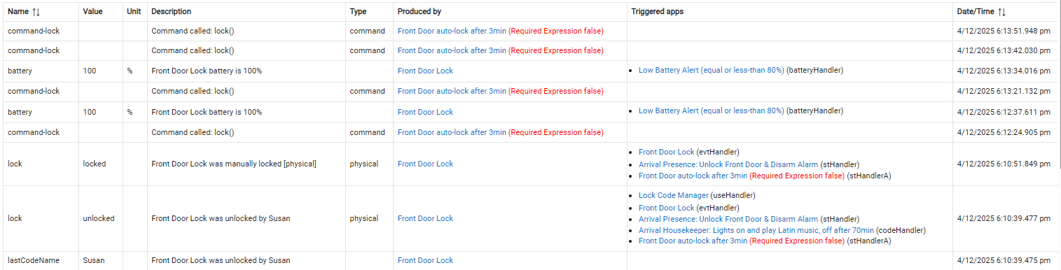

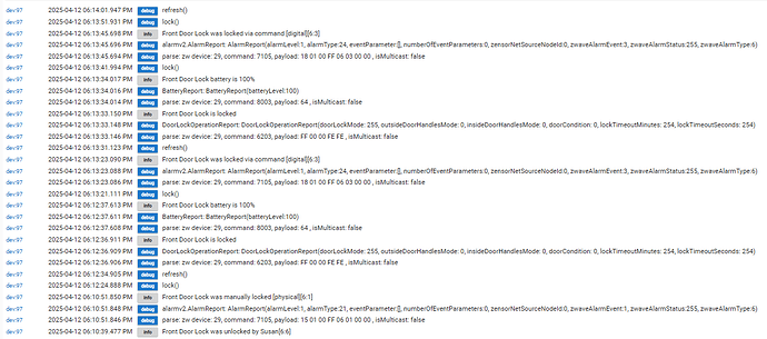

For what it's worth, I'm attaching the logs of a test run (door unlock via keypad and subsequent manual lock). I did observe something a little odd while monitoring the dashboard on the phone app. After manually locking the door, the app in-kind showed the door locked, briefly switched to unlocked and quickly back to locked again. The logs below don't seem to reflect this strange occurrence I saw in the app. A second test did not duplicate this.
Plus, perhaps a separate issue, but I also noticed the logs reported "locked via command" twice after it was already manually locked and the related rule command's required expression was false. Not sure if that's normal but doesn't seem right.

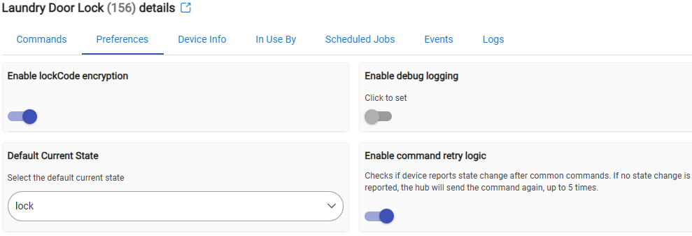

With Z-Wave JS, have you tried enabling command retry logic?
