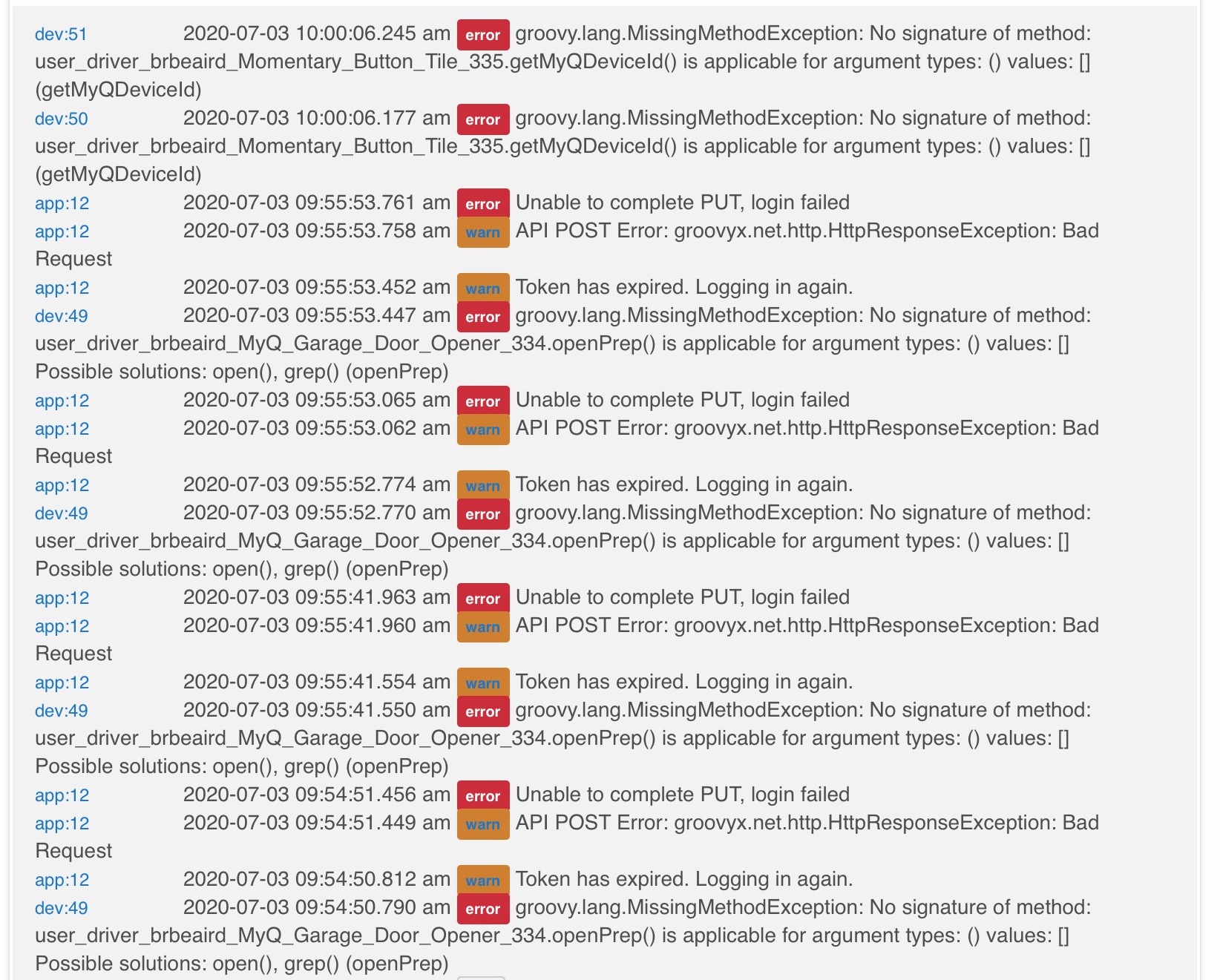

I setup MyQ lite and it has been working fine for several days until this morning. Seeing these messages in the logs...
app:1612020-07-03 06:52:33.872 am errorUnable to complete PUT, login failed
app:1612020-07-03 06:52:33.868 am warnAPI POST Error: groovyx.net.http.HttpResponseException: Bad Request
app:1612020-07-03 06:52:33.602 am warnToken has expired. Logging in again.
app:1612020-07-03 06:52:33.452 am errorUnable to complete PUT, login failed
app:1612020-07-03 06:52:33.449 am warnAPI POST Error: groovyx.net.http.HttpResponseException: Bad Request
app:1612020-07-03 06:52:33.156 am warnToken has expired. Logging in again.
--- Live Log Started, waiting for events ---

I'm also having the same issue. Getting login failed messages in the logs, but I verified my login information is correct. This was working fine for several months.

Ok login problem solved, now this error.
Installation Details:
There was a problem updating devices: groovy.lang.MissingPropertyException: No such property: deviceType for class: com.hubitat.app.ChildDeviceWrapper. Line number: 553 Last successful step: Sensor Indexing
